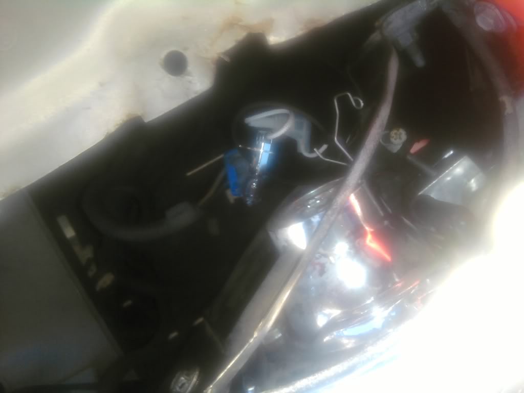

i neeed helppp
so i bougth a pair of hallo lights a while ago an i decided to put some hids on `em so i bougth them and when i was gonna put them the low hid beam didnt fit on the halo projector any common issues, any solutions,

is it the right bulb size?...maybe your projectors use a d2s or d2r bulb...i know my projectors will take a H9 regular bulb but not a H9 HID

yeah i bought the ryte size hb4
but it leaves a gap between i got some pics so you can see wat im talking about just tell me how to upload them

Re: halo ligths issue
here re some pics so u can see wat im talking about
maybe u can help

It looks like the bulb in the lower pics is an H3 bulb- Get a different style of HID bulbs, for some reason there is a difference between what the headlight says it calls for and what it takes.
If you put a different length bulb in that housing it won't work properly..if you already have the ballasts all you have to do is order the bulbs themselves- they are only $15 a set from DDM.

yeah i checked and it takes h3 as well
