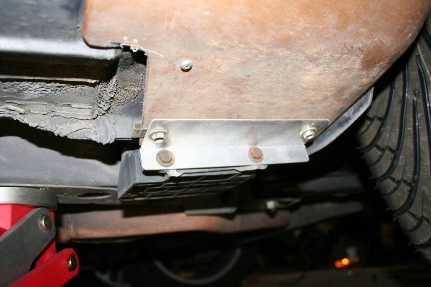

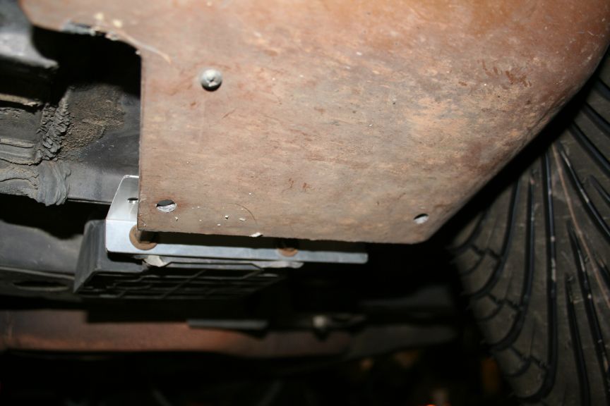

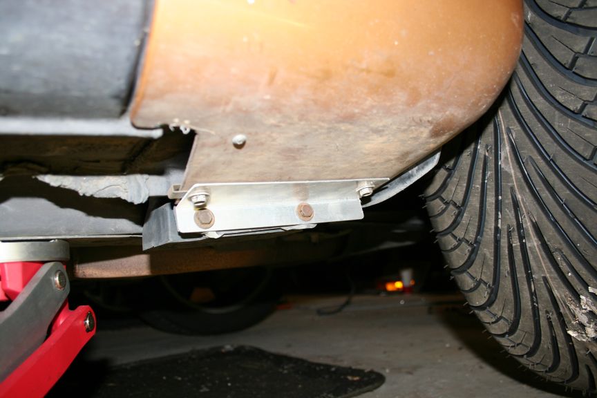

Chances are they broke the bottom plastic tab off the fender, this is how I
fixed mine during my 93 to 98 conversion :
Tom
Tom
Thats a real nice fix! Where did you get the piece for that and what dimensions and where did you drill the holes in relationship from the edges?
Old Nov 25, 2006 | 09:56 PM
sbca96's Avatar
Joined: Oct 2006
Posts: 273
From: Santa Barbara, Ca

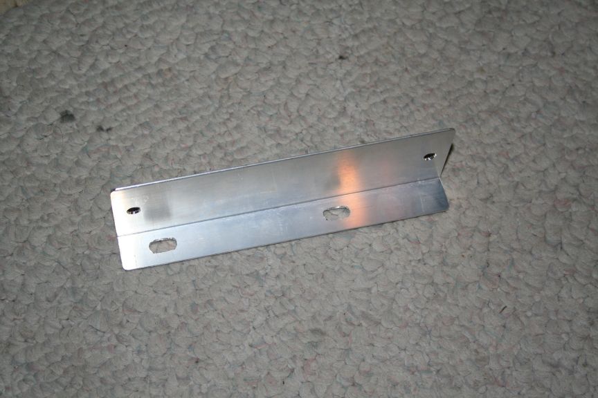

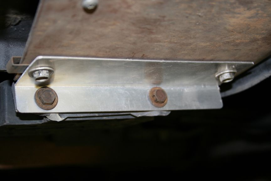

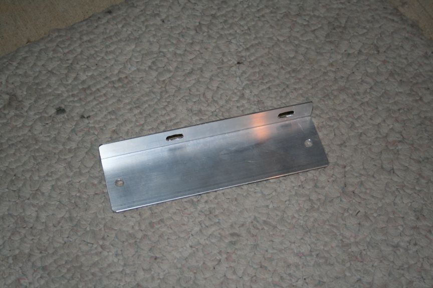

Its a piece of aluminum channel, was in the scrap bin at my work. They got it
through a metal dealer, but I would guess you could find some at Osh, Home
Depot, or Ace Hardware. The piece is cut to the same length as the metal on
the body. The channel was the same length (roughly 1.5") on each flat off
the 90 degree, but I cut the one side down to the same length as the metal
on the body. I used a non broken fender as a guide to figure out where to
put the holes with the channel on the outside. The fender holes were the last
drilled, and were marked with the aluminum bracket bolted to the car, and the
fender lined up in place. Then I drilled the holes through the fender, and had
to notch the edge of the fender for the hole closest to the wheel, so that a
captured nut clip (pulled off the 93 fender front bottom edge) could be used.
You dont want to just thread into the plastic fender as it will break over time.
EDIT : Oh .. as for the hole locations on the fender, I just made sure they are
in far enough to leave enough material, and not so far that the clip wont fit.
That was why I had to notch one edge, the hole was in too far. The clip on
the rear one you can see in the picture, the clip on the front hole come in
from the inside edge, rather then the wheel well edge.
Tom
