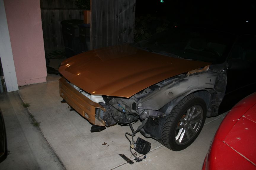

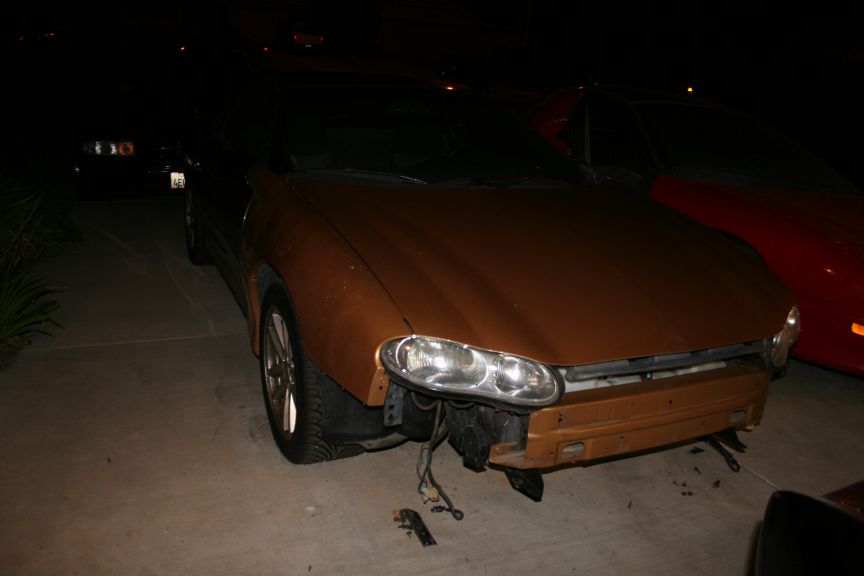

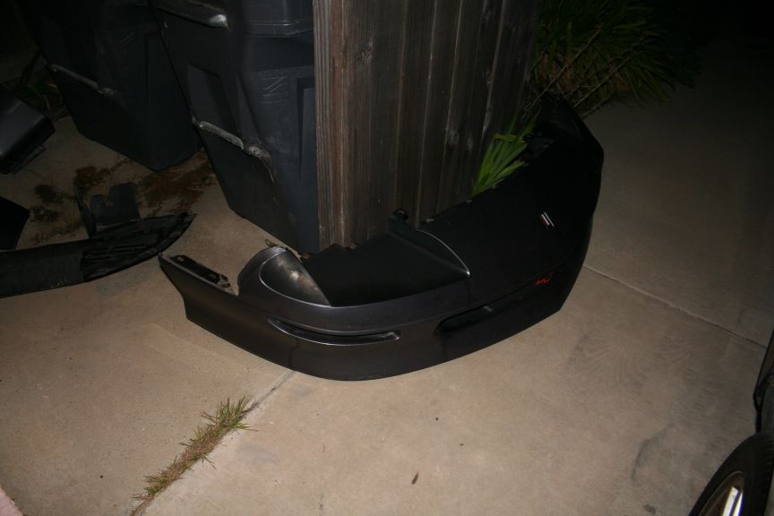

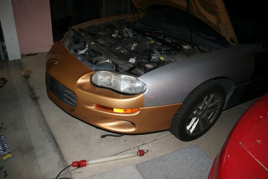

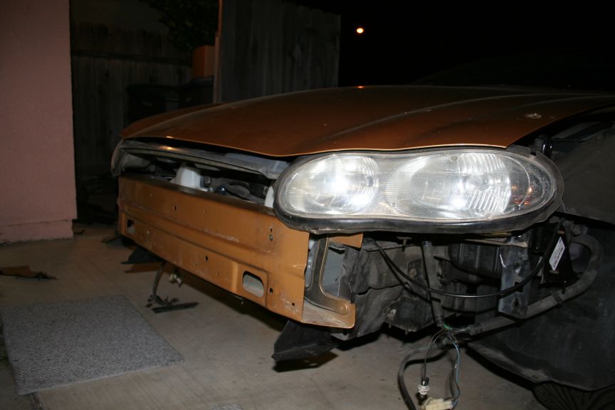

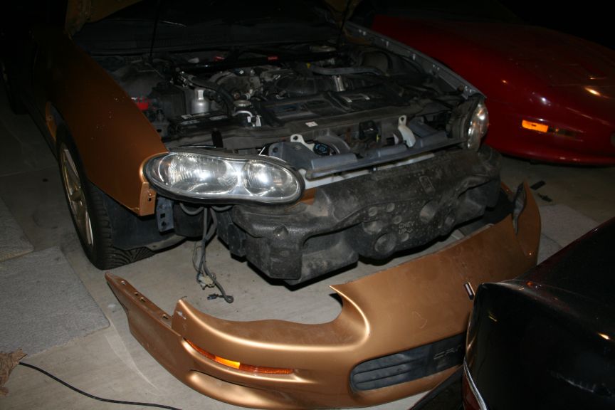

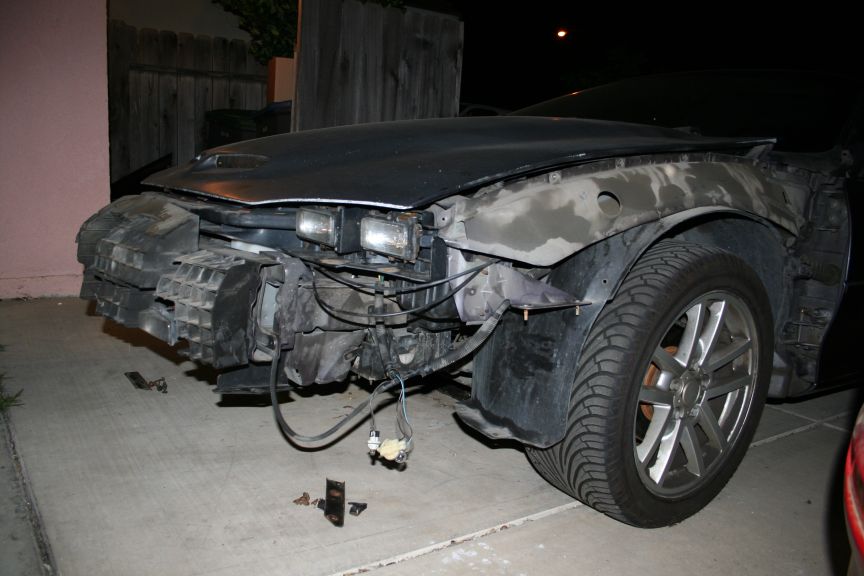

Not really going to bother with a tutorial of sorts, but here are a few pics of
my swap that might be a useful footnote to those considering this swap.
https://www.camaroz28.com/forums/sho...d.php?t=425550
My reason why its getting swapped, figured if I am replacing all these parts, I
might as well end up with the style I like better.

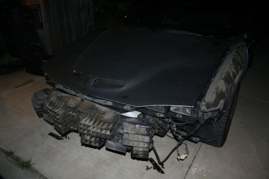

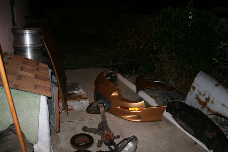

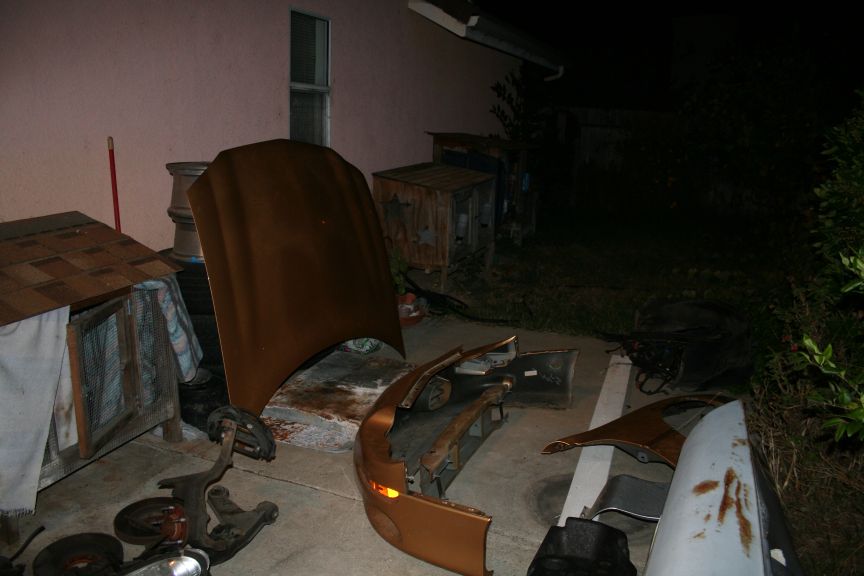

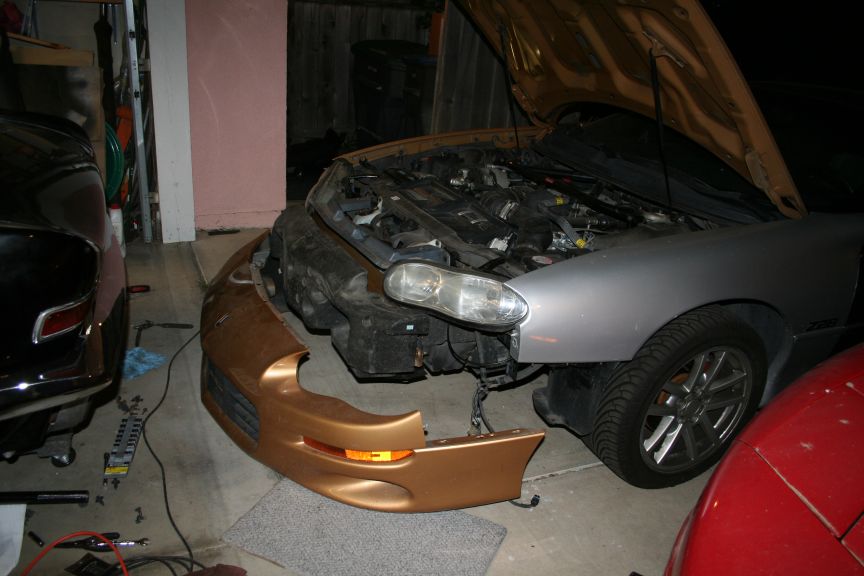

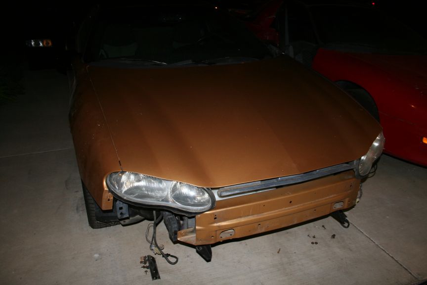

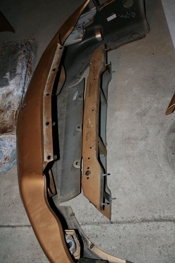

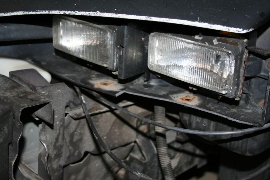

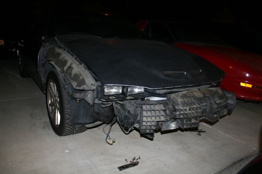

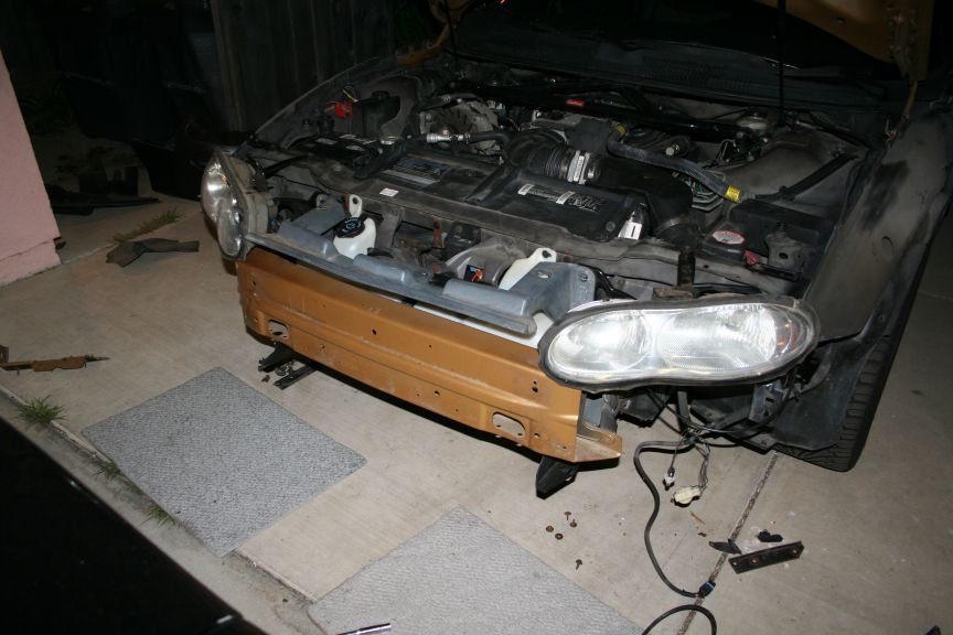

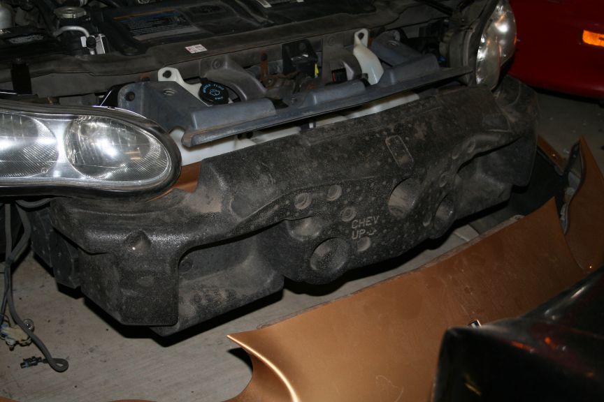

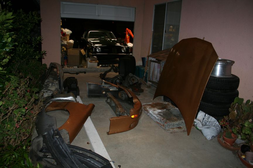

Here is the teardown, I found that the hood bumpers that are WELDED to the
body are over an inch lower on the 93 then the 98. I will have to make some
adapters to make them taller.

Is that an Avanti in your garage? I've never known anybody that had one of those before.

Yah, its an Avanti alright, someone else on this forum thought it was a Pacer?
Good eye. Granted it was far away in the shot of the damaged Camaro. Here
is the link I posted up some info :
http://web.camaross.com/forums/showthread.php?t=481491

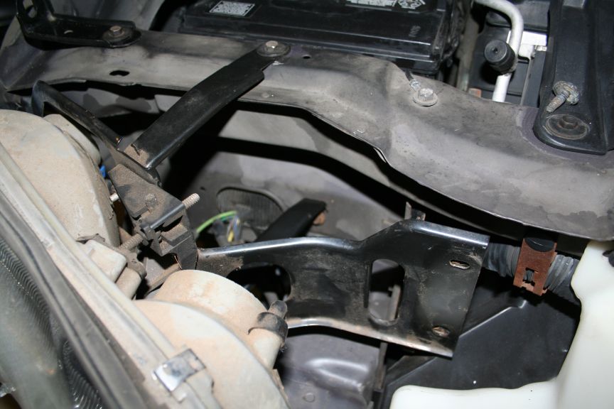

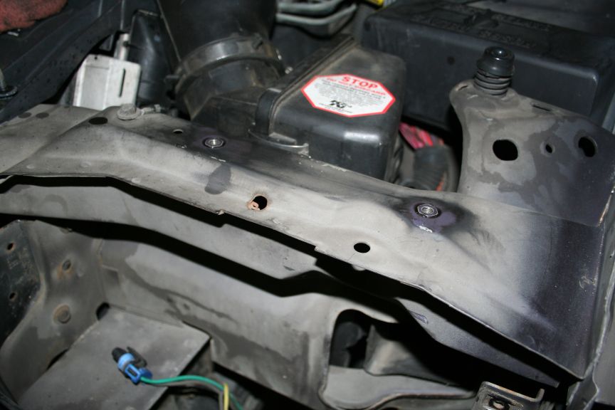

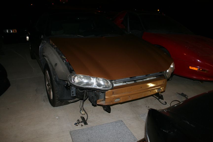

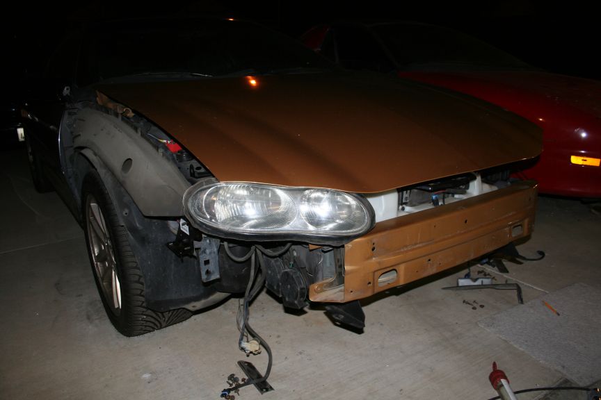

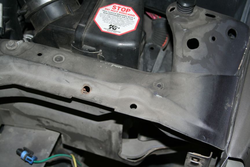

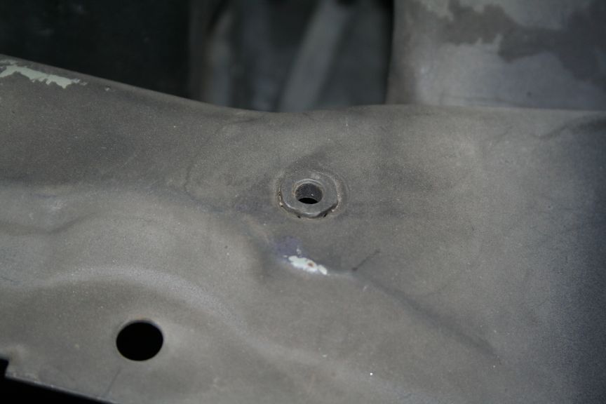

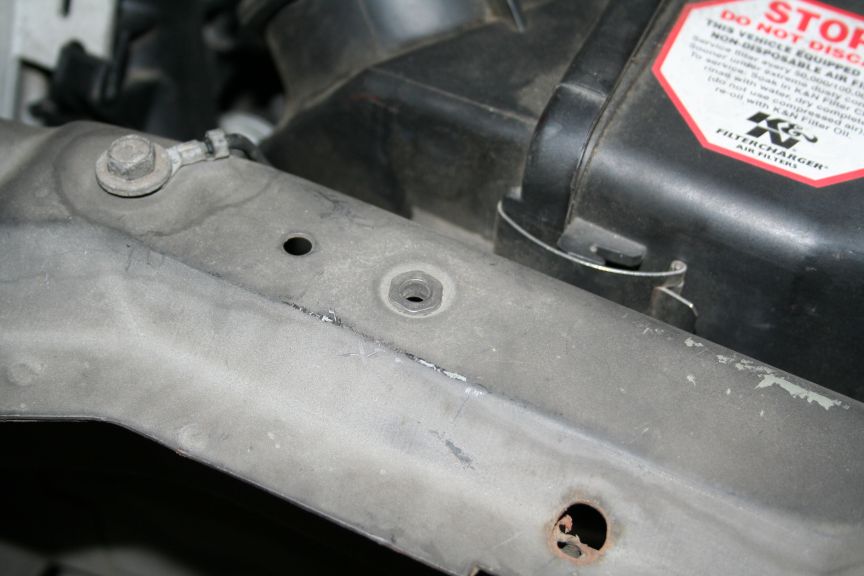

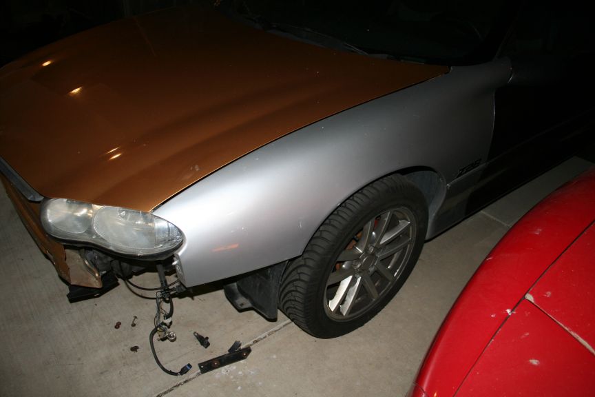

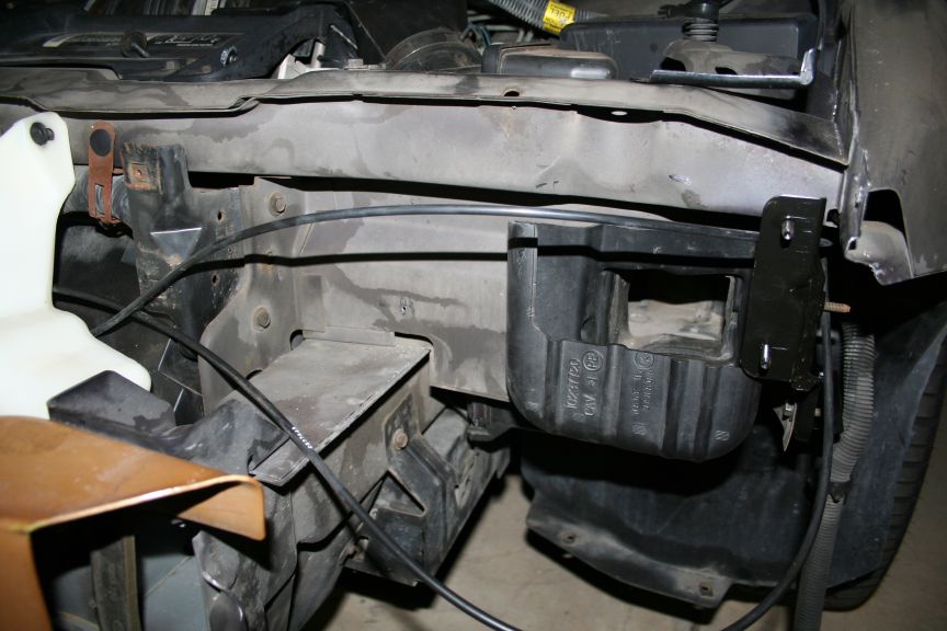

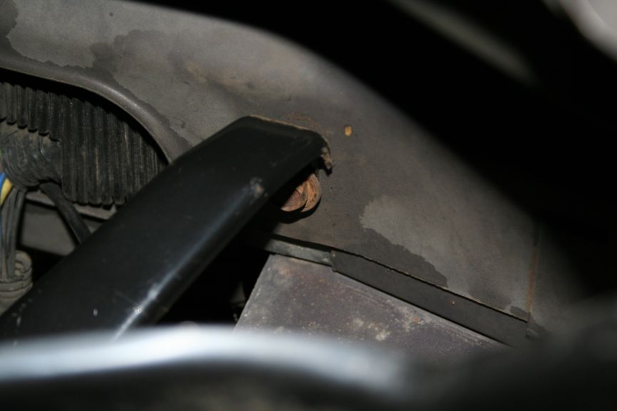

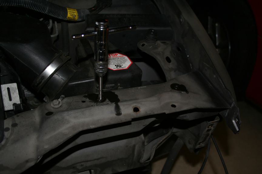

Here are more pictures, these two "nuts" are already in the front structure, but they are not tapped
for a screw. I guess you could TRY to force a screw into them, but I ran a M6 X1.0 tap into them :

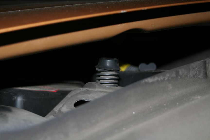

Got the hood and crashbar on first :
These mounts are about an inch lower on the "LT1" cars. I will have to fab something up :
Hood lines up ok, but I had to move the latch down later :

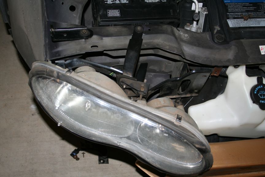

Mounted the headlight up so I could mark the lower hole to drill.
Tom
Old Nov 13, 2006 | 04:02 AM
sbca96's Avatar
Joined: Oct 2006
Posts: 273
From: Santa Barbara, Ca

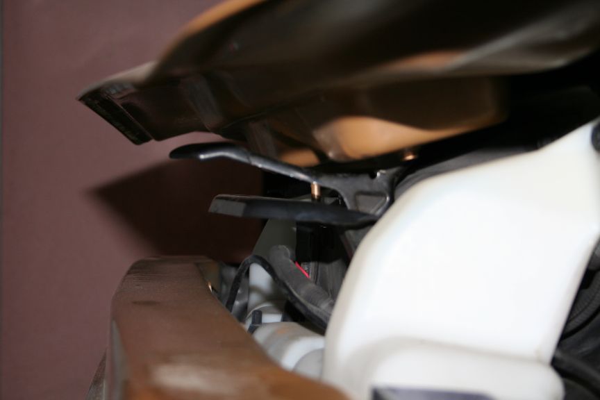

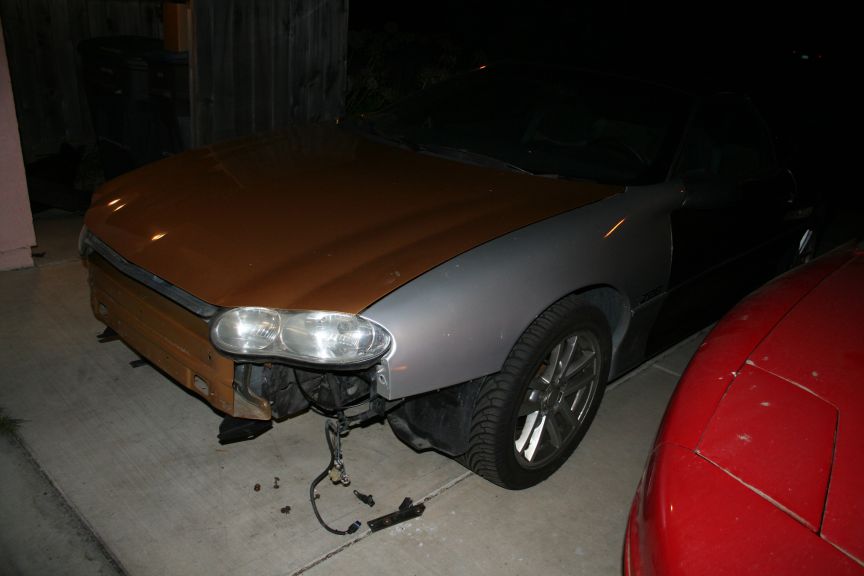

I just used a 1/8 th drill bit, and ran one of the self tapping screws that held the old headlight assy
onto the front structure. BUT .. Do yourself a favor and REMOVE the battery, pull the harness up
out of the way behind the sheetmetal on the passenger side!! I drilled the hole and THEN realized I
might have drilled into some wires!! I got LUCKY ... the bit went between everything. I used a piece
of plastic in between the screw and the harness, and also dremeled off the sharp tip after I made
the tapped hole into the sheet metal :

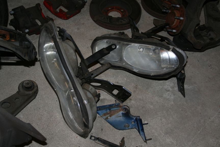

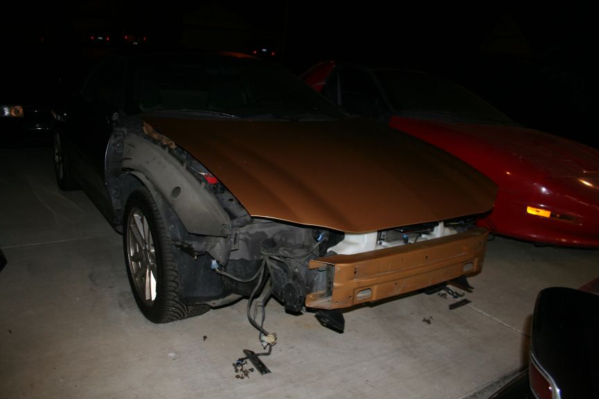

New brackets ordered from GM. These are the ones that the guy forgot to pull off for me :
That big gray piece holds the nose on, make sure you get that too!

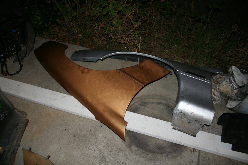

Got the silver fender on :
Got the gold fender on, but there was a problem .....
Tom

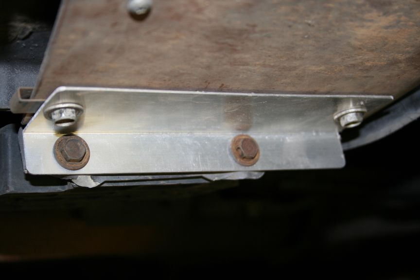

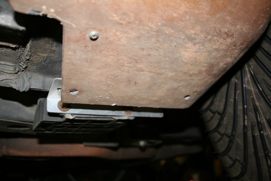

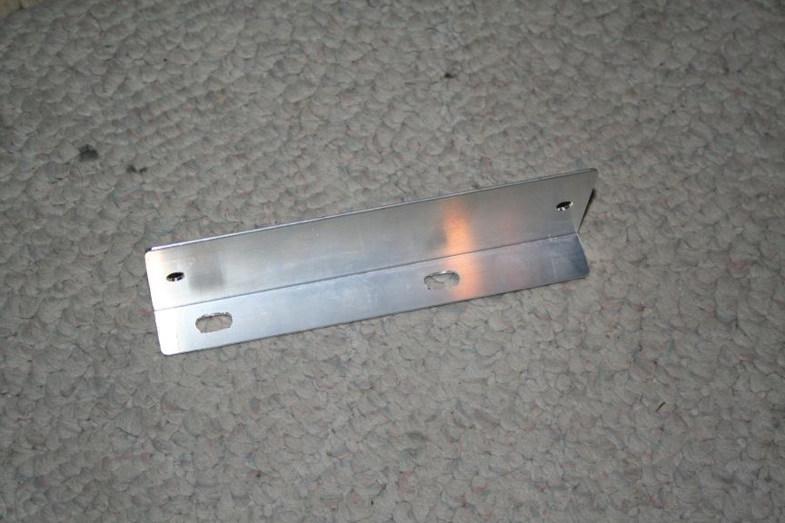

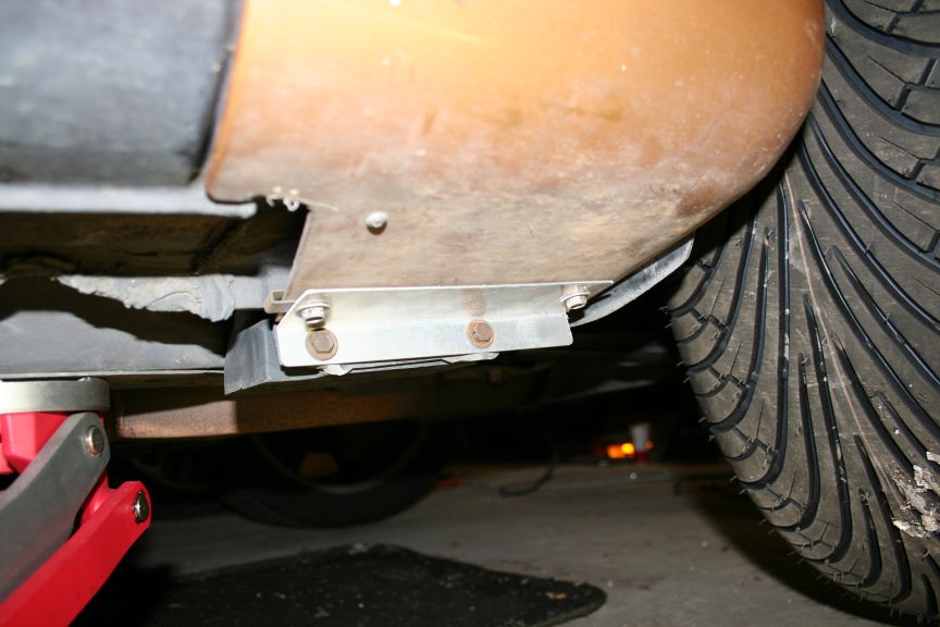

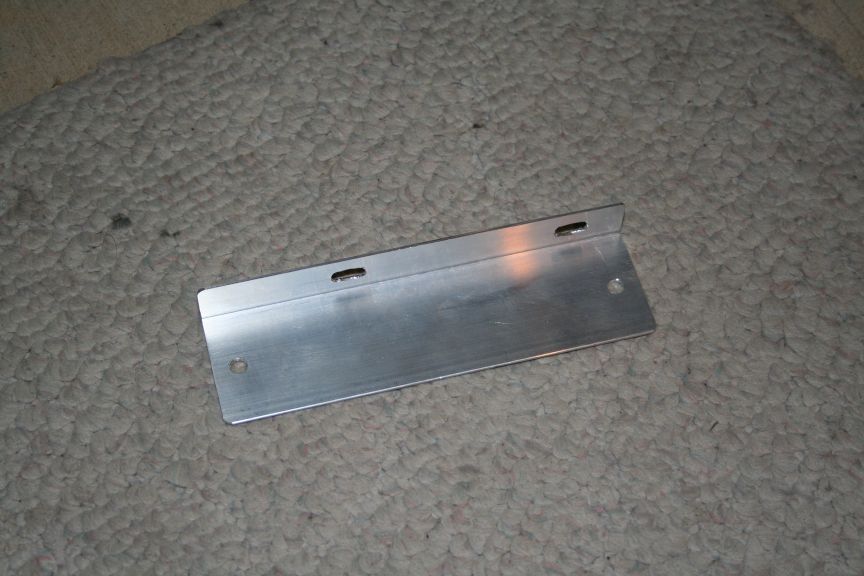

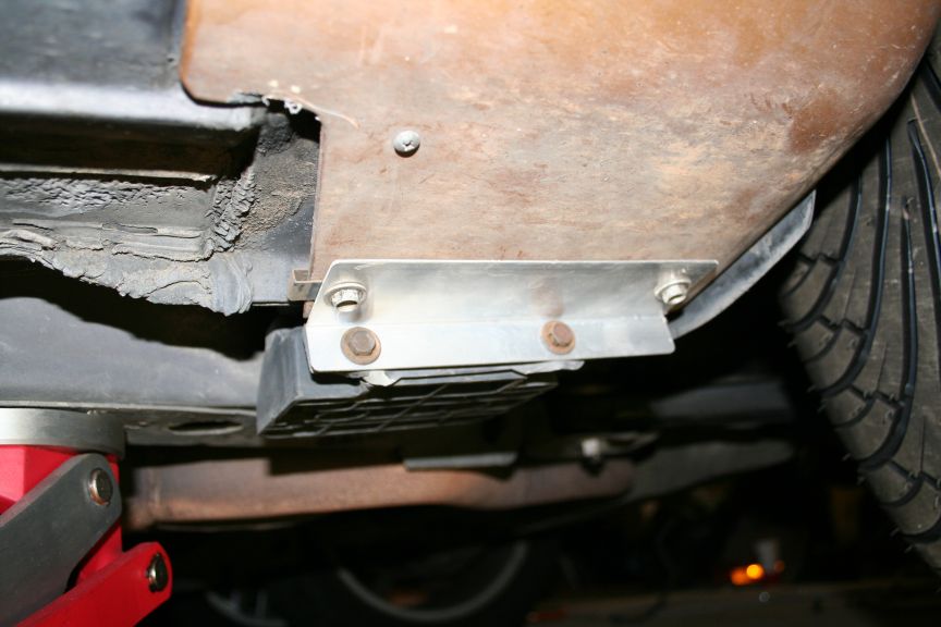

The gold passenger fender is missing the bottom mounting tab, so I made this from aluminum angle :
Drilled two holes to add some captured nut clips :
And bolted it up :

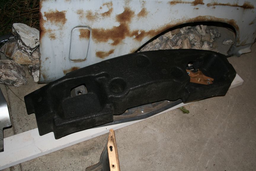

The styrofoam nose is held to the crashbar with two of those quick clip deals. They are longer then
the ones that hold the nose on :

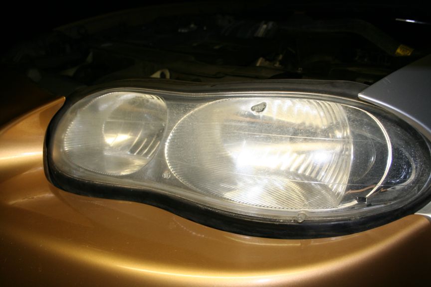

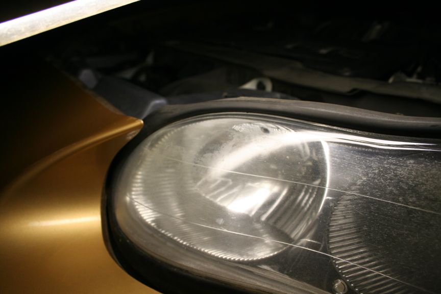

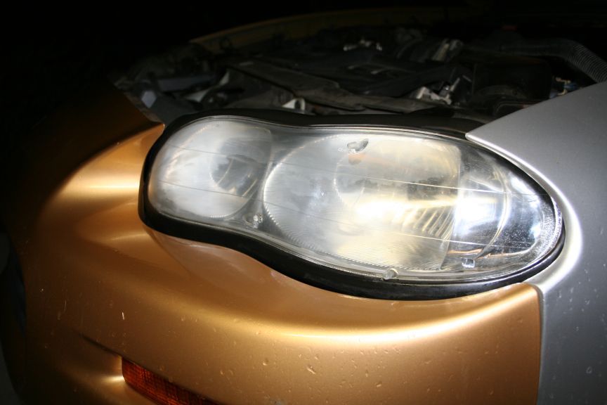

headlights pretty boogered up, foggy, scratched and yellowed :
After wet sanding with 1000 then 2000 grit :
Tom
