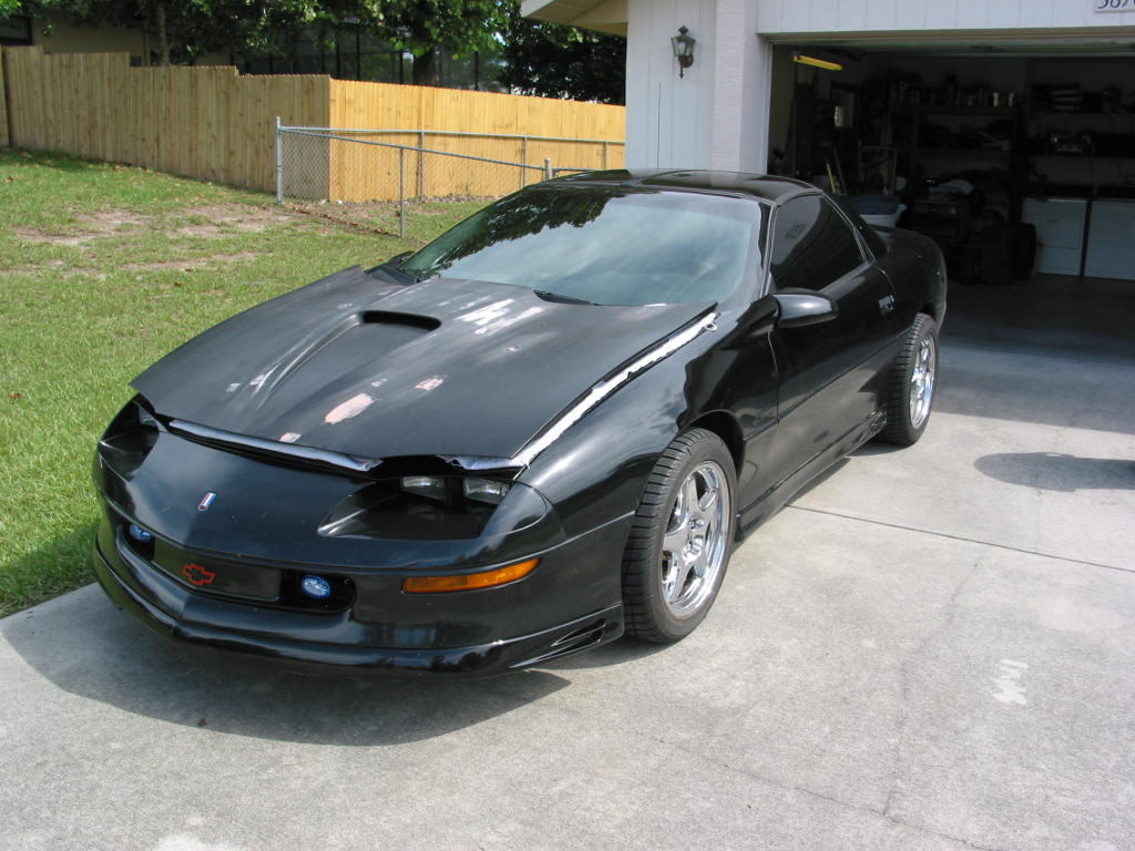

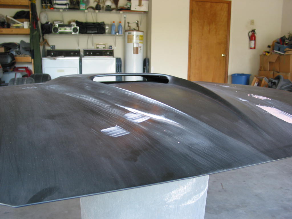

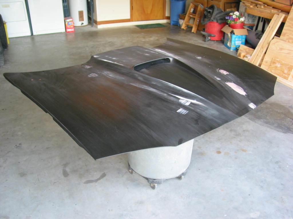

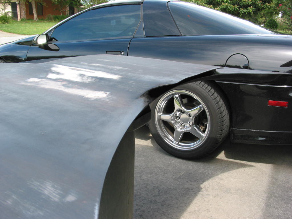

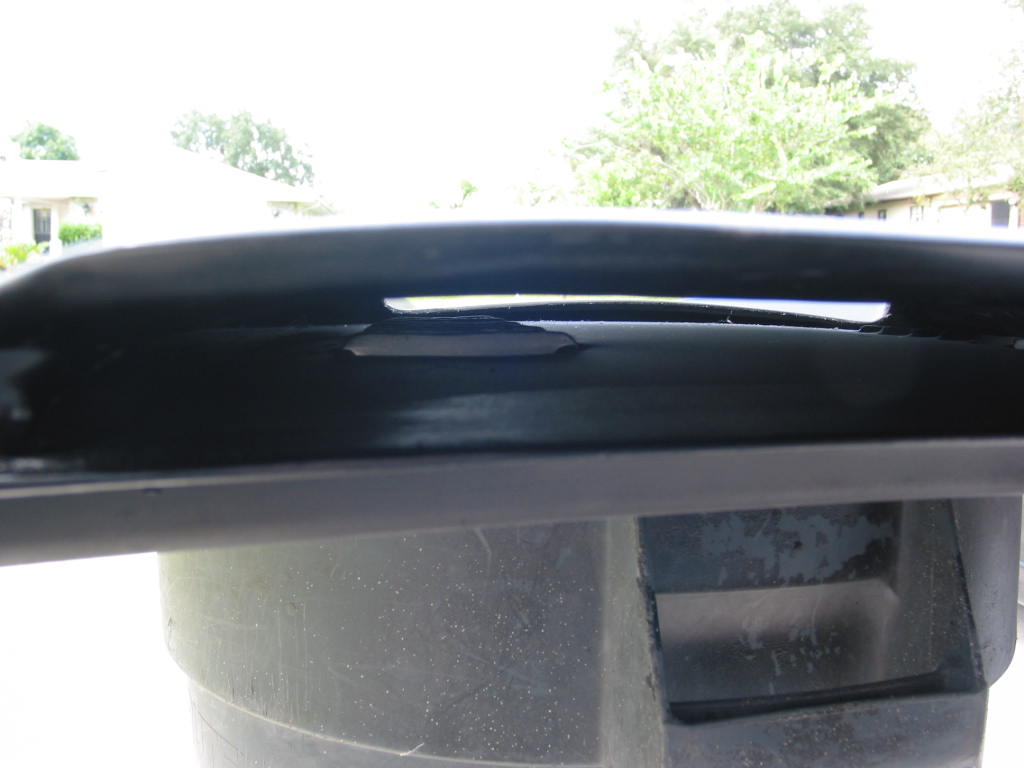

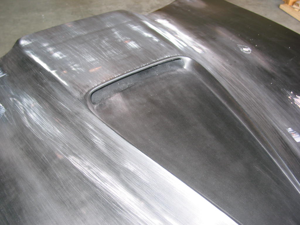

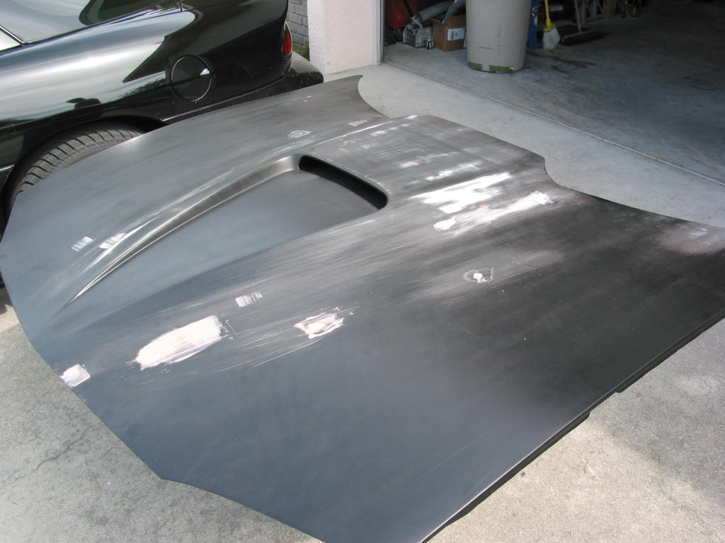

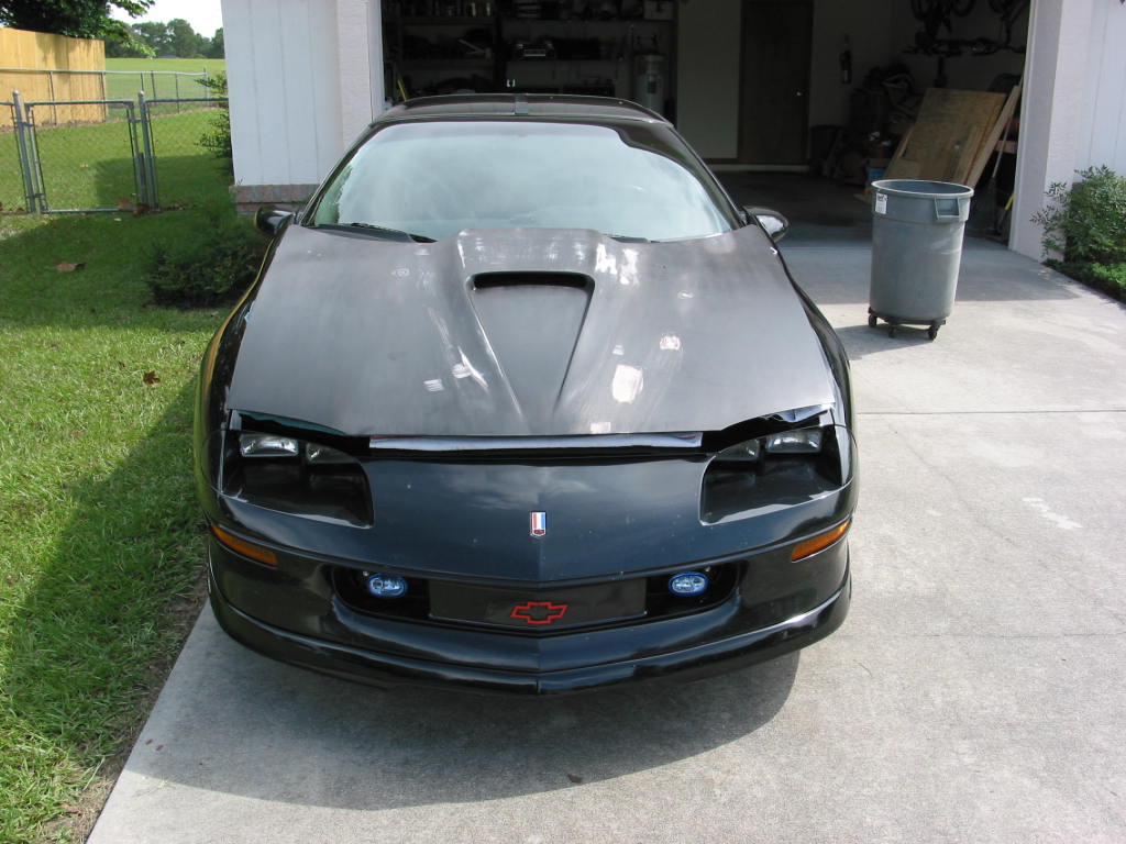

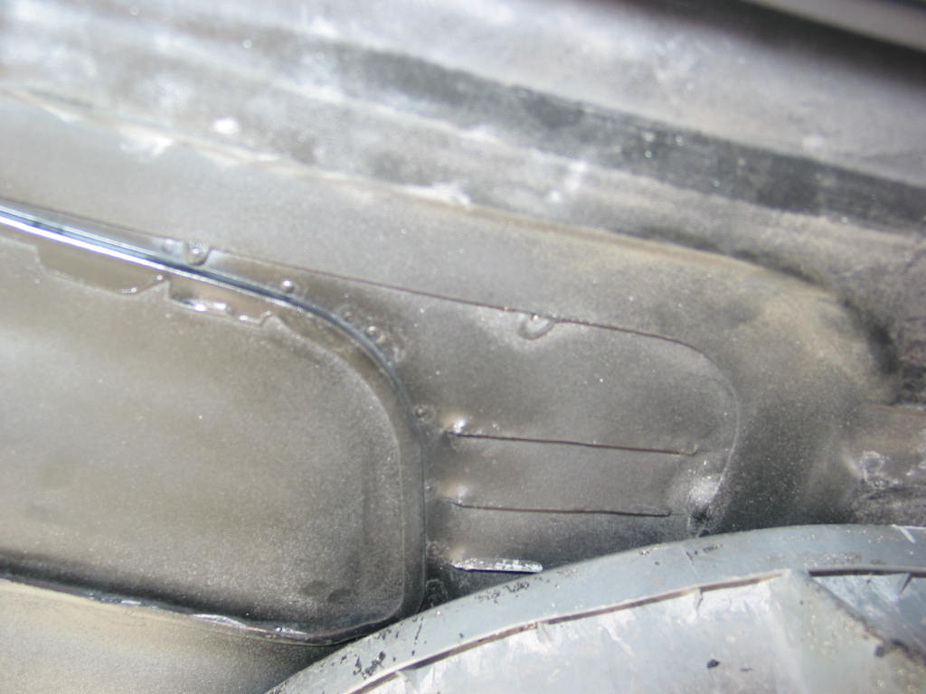

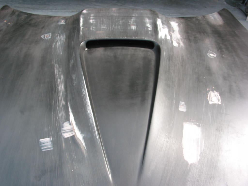

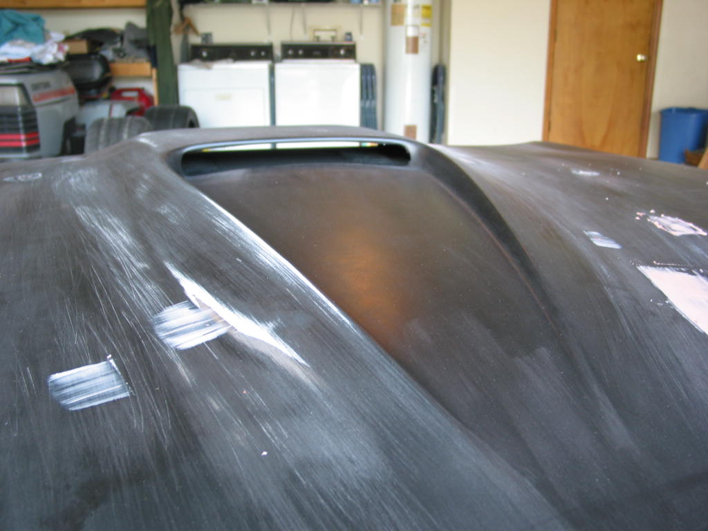

A local buddy of mine is just about done making a custom hood for his 95 Z28. He started out with a stock steel hood. He filled in the "vents" and molded on a SS style scoop but narrower and with longer "ridges" going down to the front portion of the hood. While it looks similar to an SS hood it is way different. The scoop area actually goes all the way through to the back of the hood. Instead of the scoop acting as an intake it is a pathway to create a low pressure area. Then, under the SS scoop he has cut/punched ventilation slots in the stock metal. The idea is to have the under scoop area act sort of like a venturi and "suck" the hot air from the engine compartment up through the slots under the scoop and discharge it out the back of the scoop. Will it actually work? I have no idea but it certainly sounds plausible
I went over the other day and took some pics. We even laid the hood on top of the car so you could see kinda what it looked like. I didn't get very good pictures of the punched vents though.

The ZL1 style uses a huge scoop... he wanted a smaller and narrower scoop. Plus, and this will answer the other questions, the scoop came from his trashed import hood. He had a killer Honda Delsol (sp?) which had a Kamari hood (or something like that) and some lady pulled out in front of him. He cut the scoop out of the hood and stuck it on a stock steel hood
