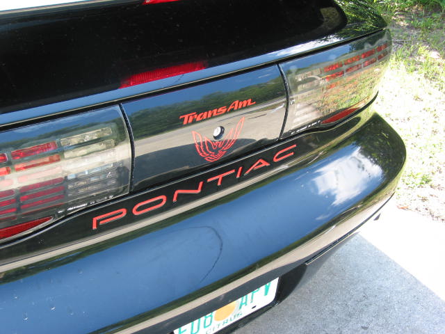

You pointed him to that site that has the vinyl birds. I can make similar except I designed my own to be exact duplicates of what is already painted on there so they are kinda like "overlays" with no sanding required. I designed the bird and the "TRANS AM" in the following picture.
http://www.bfranker.badz28.com/vinyl...irdPONTIAC.jpg
