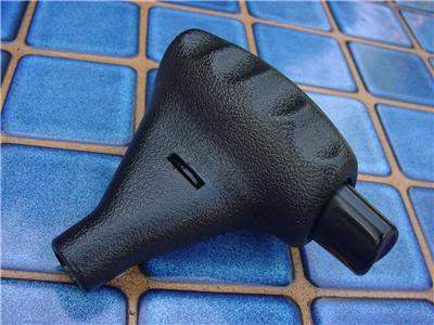

Will a T-handle from a TA work on a Camaro? What is needed to do the swap? Is it pretty easy to remove the old one from the Z28?

Yes, its a direct replacement. Remove the U clip from the front of the shifter and it just pulls off. Put the T handle in place and put the clip back in.
I just bought one of these, been looking all over for one with the finger grips:
Thats the exact one I'm getting. Do I just remove the U clip with needle nose pliars??
then it just slides off.

Easier to just use a small screwdriver blade then a pliers to remove the clip. Much nicer than the button on top and looks better too.
