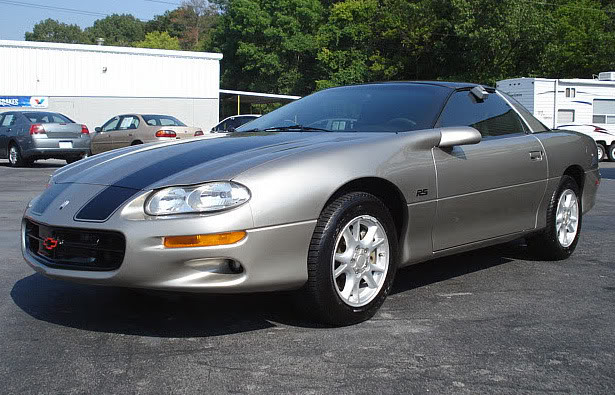

If I had your car, I'd just focus on some of the appearance stuff. Get a set of SLP RS stripes if you can find them and the SLP grill. You already have dual exhaust and SS wheels, so maybe you could upgrade the brakes to Z28 brakes. I've seen someone change their V6 engine to having the Z28 air intake (technically they used SLP blackwing air intake) and probably a larger throttle body too. I suppose you could do those as well, but I don't know the work involved or if your engine would throw error codes or need to be tuned for the increased air flow.
Here's a pewter RS with the stripes and grill.
