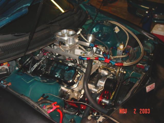

Here is a similar EFI setup.... 278/288 degree @ .050 cam, if you can call that streetable.
http://www.lonniesperformance.com/mustang.htm
That motor sure looks familiar..
http://www.outlawdragradial.com/bigblock/dsc00604.jpeg

Re: Results of carb to EFI conversion
Brady,
What a coincidence..... It used to look like a Camaro though.
But, it will look different after the ProCharger goes on.
I even hope to put on a few street miles this year. I think it will attract some attention.
