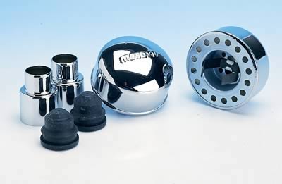

I'm running a pair of the Moroso breathers on mine.
http://static.summitracing.com/globa.../mor-68730.jpg
Should do the job just fine.
