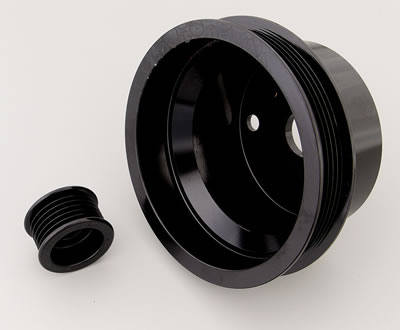

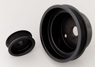

Here's its equivilant at summit racing equipment:
http://store.summitracing.com/partde...5&autoview=sku
Performance ratio:
It looks as if you can get the fifty buck "standard ratio" pulley set for $54, or the "performance ratio" pulley set for $110. I have the performance ratio set. Now, I guess I have a hybrid between standard ratio and performance ratio. It works just fine now, thank you. No need for a smaller alternator pulley. In fact, what you dont know is that I also use a 14 pound, 15 AH mini-battery to power my car.(Genesis gell-cell). If anyone would have had troubles due to insufficient charging, it would have been me. I've been using the Genesis-series since 2004 and it's never failed to start the car.
Standard ratio:
You better take another look at Summit's underdrive catalog, by the way. The "standard ratio" shown above is the only one in their catalog with the smaller alternator pulley. The rest all have the larger diameter alternator pulley. Therefore, it seems as if the larger pulley may be more popular than you think.
Performance ratio:
Standard ratio:
