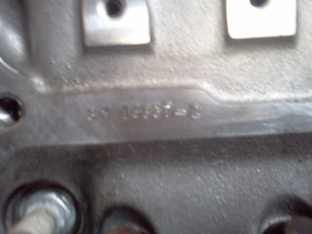

ive got a pair of heads on a tpi that i acquired a couple of years back and would like to rebuild the tpi before i put it in my hopefully new to me iroc z but i have no idea where the heads came from and was hoping to get some info in here that would help. the only casting numbers i found on the right side head was "sn 13357-2" and inside the valve cover i found a series of numbers that i hope can help. a circle with an A inside of it, a 1 under that, and 2635 undern that.

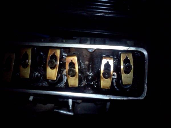

for some reason i cant add pics. but the heads are aluminum with canted valves like the 454 and canted spark plugs like the lt-1. they have no markings front or back to let me know where they came from and they have a center bolt pattern for the center bolt valve covers. and i dont know if it matters but, it has a set of roller rockers with hydrolic lifters and a roller cam a presume.

TrickFlow made tons of the Twisted Wedge "canted valve" heads for the SBC. They were really popular back in the late 90s/early 00s, especially with the TPI crowd. That's most likely what they are. The TF casting numbers usually began with SN.

i checked threw the trickflow catalog and couldnt find the pn. i think that my next step will be to call them in see what is found. oh and i cant figure out how to post pictures, so any info will be appreciated.

oh but i did put a quick pick in my pics of the car in my garage. its under performance. like i said its a quick pic though.

That's because TrickFlow stopped making those heads a LONG time ago.
The pic in your garage? Here it is...
I see 3 things:
1. What appears to be the TrickFlow Twisted Wedge heads, the first/original design (referred to as G1).
2. Incorrect rockers.
3. Sludge!
Chances are if it's got a TPI intake, they're TF heads. Canted valve heads are usually high dollar max effort pieces with huge intake ports that won't line up with a TPI base. They're not true canted valve heads.

Yeah I was very disappointed when I saw all of the sludge build up. I'll check with trick flow to see what the recommended parts were to put them on correctly and to see if it would even be worth rebuilding with these heads. Thanks for the input.

thanks jp. do you know how to get a full photo in the thred like the one above.

Yup. Those are the TF Twisted Wedge heads, 100% sure.
