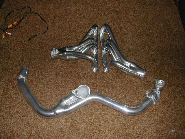

the collectors are in the middle, so they would be prolly where the cross member is on our cars
http://www.thirdgen.org/techbb2/atta...postid=1402941
those are my headers, they angle towards the back of the engine where they hook up to the y pipe
the ceramic coating isnt a must, but itll keep em looking alot nicer, cause they get rusty. they also lower under hood temps because more heat stays inside the tube

youll have to get an aftermarket y-pipe to work with the headers. otherwise you can reuse everything after that. do you live in an area that has smog tests? if so, youll have to get headers with air tubes and a cat too=$$$
