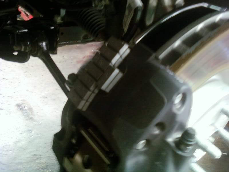

Found this on my dealers first SS we got today. Was just about to post what the hell they were doing with the wheel weights until I saw this thread.
That's 4oz of weight :O, wonder how long that glue will last with brake heat unless they are using special weights on these.

well. This is an issue. Picked up vin #6046 on wednesday and the dreaded wheel weights were on the fron brakes.
maybe some of you think that this is just a minor detail but I think it's a BIG deal. Those stunning calipers in the open wheel are completely laughed at by anyone who looks at car . Looks like a high school fix.
I cant believe this was not sorted out before cars were shipped and I expect GM to have a fix for this in the near future. I dont see myself taking my car to shows etc...and having these silly weights on there.
Looks like poop.

Hello,ground control to major tom,anyone home????? If the weights offend or humiliate you, take the things off. To be honest you can't void a warranty by removing weights of a brake caliper. And they probably only quell a pedal vibration at 90 pulling .85 G's. Think about it? It is going to have to be an extreme situation for 2 or 4 ounces of weight on the calipers to do anything. IMO I'll probably pull mine off the first day to try to find what the problem is and what driving condition causes it. If it's a big issue they'll go back on. If not they are gone. Were not talking brain surgery here.

Originally Posted by z71collector
Elaborate please.....expound......Let's do the technical dance on this
Based on the official description of the problem (post #12), the weights are there to suppress a noise. There is no mention of vibration, which would indicate that the frequency is too high to feel anything.
That in conjunction with the fact that they put weights on the calipers tells me that they tracked the vibration to a resonance in the calipers, and they're simply using the weights to change the resonant frequency of the caliper assembly to a range that isn't encountered during normal driving.
