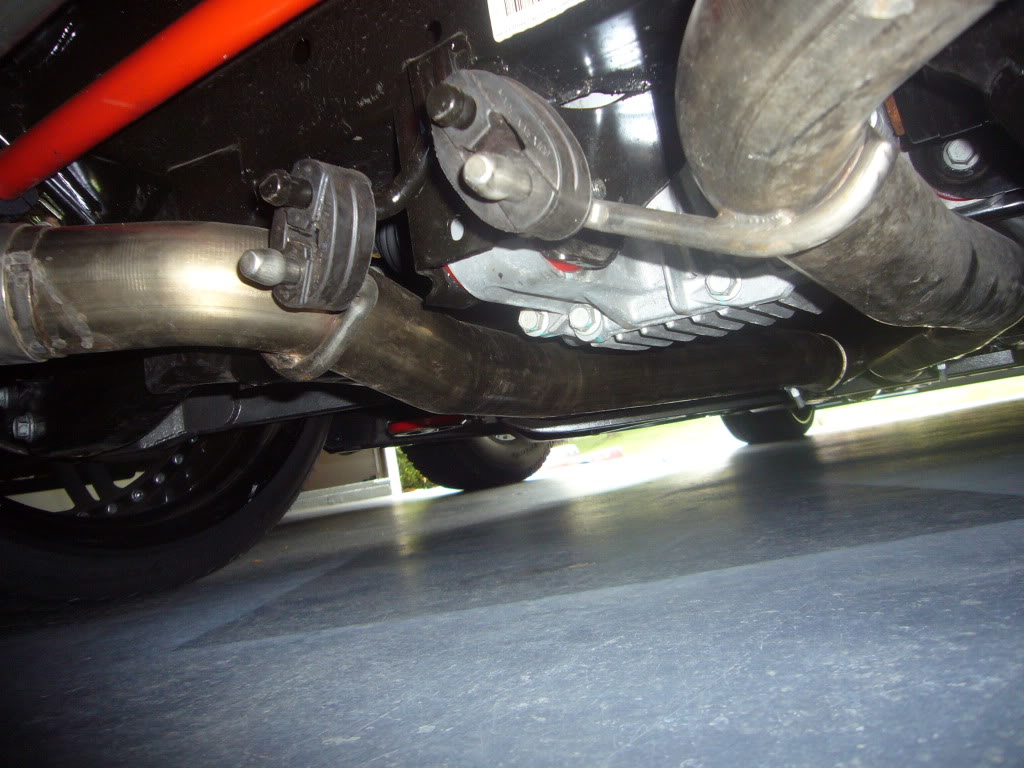

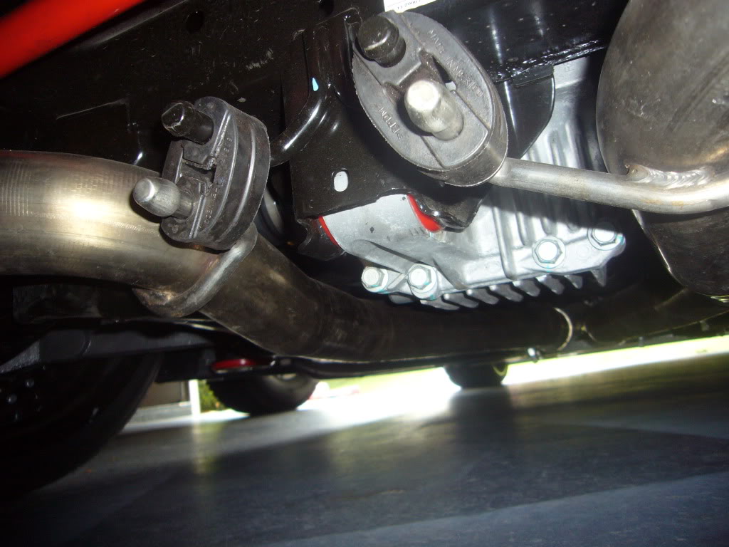

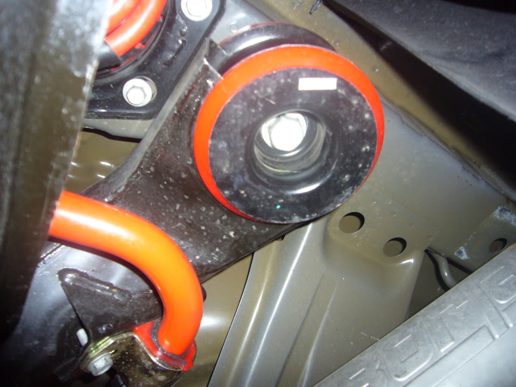

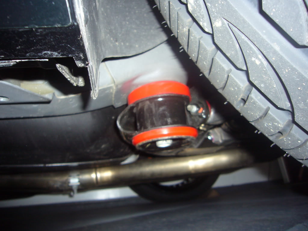

Got these put on last week at backstreet performance. subframe bushings and hd differential bushings. still have some more bushing to do, but after having to buy tires, kinda put a damper on things Name:  P1050550.jpg

What do you think of the bushings? Any decent difference?

big difference. after i put my cam in, i noticed the car got really squirrely in the back end. and not from the tires cutting lose. just the bushings giving out. these fixed that. its nice and tight now. these are the heavy duty ones that they offer. there is a mid grade good for up to 500hp, but these are the solid bushings not the inserts. a bit more expensive, but worth it. you can hear the gears also with the diff. bushings. but its not a huge deal. i got alot of noise going on with my car(in a good way) and its not too noticeable.
