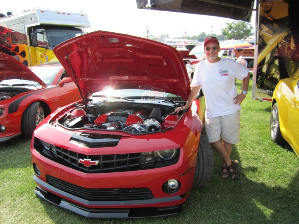

I just had to put in my two cents...
Mudbone and the Pedders Camaro at Carlisle.
And I am glad you did. How are you?
