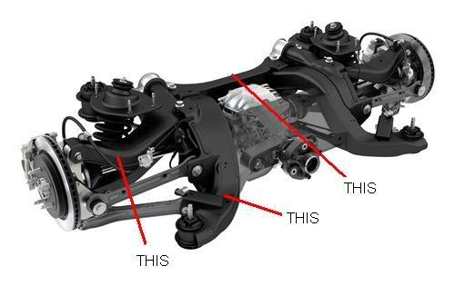

Originally Posted by CLEAN
I need something answered before I can put my 2 cents in. Has it been discussed anywhere how much it would cost to do the cars unit body in aluminum? And how much does the current steel unit body weigh?
Here joo go man...
http://www.ussautomotive.com/auto/steelvsal/cost.htm
Originally Posted by posaune
Not sure but wouldn't it require some tooling changes to use aluminum in stead of steel??
Yes.
And design changes. Freaking cubic metric a$$-tons of them.
You can do things like that, but the prime candidates are things like doors and hoods and decklids and roofs and front fenders in a car already made of steel... stuff that sometimes doesn't have to be welded to other stuff that HAS TO be steel.
-OR-
Stamped steel assemblies that you can turn into machined aluminum castings OR stamped aluminum assemblies.
Here... I'll show you an example on that IRS...

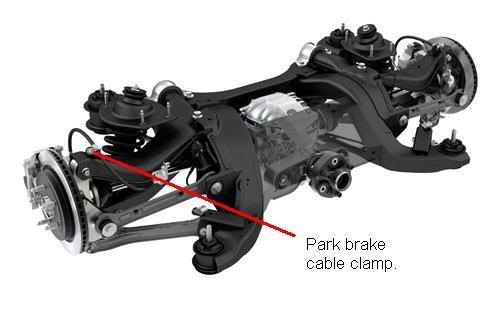

To the thread starter...
Want to make this a REALLY profitable exercise?
It'd be really cool to have complete car to look at, closely, for a few hours - maybe a day. Maybe take a couple of things apart on...
Here's a freebie right here:
I think maybe you can eliminate that part right there on both sides. Bang two holes in the upper A arm, throw a $.01 grommet on each side, and route the park brake cable THROUGH the A arm.
It captures the cable for you (so it won't get smashed when the suspension moves), routes it for you, elminates the cable clamp and fastener and saves weight AND money.
Now... for some math...
That clamp probably costs $.20 or so a piece, and the fastener for it probably costs $.04. Then you have the labor to install it... we'll call that a wash with the labor required to put in the two grommets on each side... you can push those in by hand and no expensive torque-monitoring tool is required...
We'll say the grommets cost $.02 a piece to be a little conservative...
$.48 per car savings from eliminating the clamps ($.24 * 2)
Minus $.08 for the grommets... ($.02 * 4)
Leaves $.40 per car savings.
$.40 per car * 60,000 cars = $24,000 per year
$24,000 per year * 5 years = $120,000 savings over life, and we might have saved a third to half a pound there.
Prototype costs? Near zero. Gimme a drill and a can of POR and I'll prototype the A arm for ya... I'll dig out my own grommets out of somewhere...
We'll put those holes in the best place we can structurally, and since they're on the downstanding flange, that material isn't doing a whole hell of a lot anyway.
