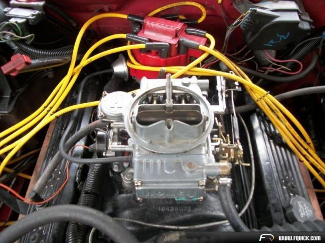

The engine is out os a 94-95 truck. I switched it from TBI to carb. It was an easy job. All I did was drill out the 4 center bolt holes 2 on each side in the center on the intake and hand milled them flat you cant even tell it was done.
