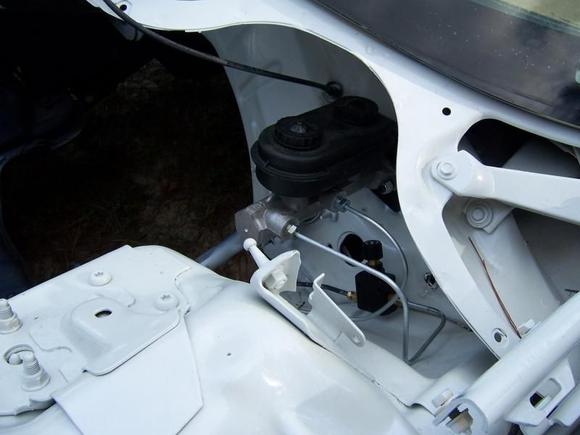

The LT4 won't make much vacuum with the mech roller cam, so out goes the ABS, vac booster, in goes Wilwood Master Cly. and adj rear prop valve
