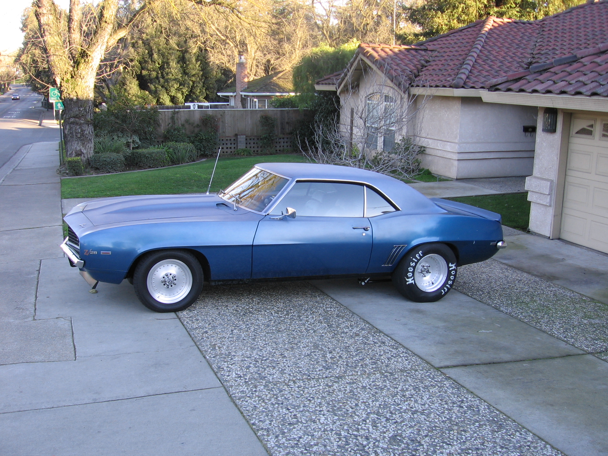

Yes they will fit. Here is a pic of my '69 with a 10" rim and 28"X10" slicks. I also ran 275/50/15 tires on it.

The back spacing on my rims are 4-3/4". Rims with 5" or 5-1/4" BS would work a little better.
With the old 13:1 compression 350 on a 175 shot my car ran ten teens at 132. I ran it on pump gas around town but raced it on 116.
