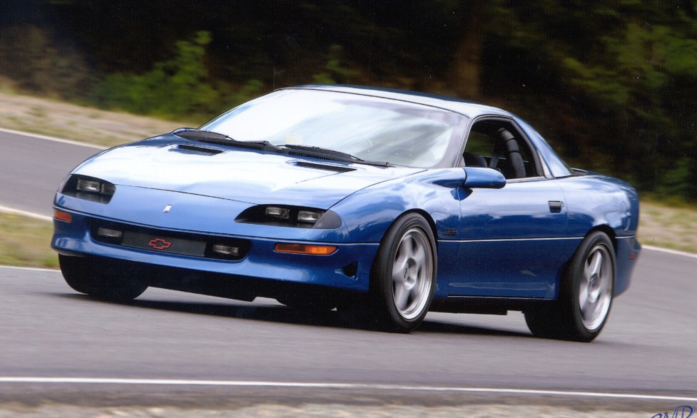

I wouldn't want to daily drive with 315's on the front. But I do like them at the track:
http://www.jonaadland.com/NewPics5/CMsmall.JPG
Those are 36.5mm (ZR-1) offset. More pics in the sig.
