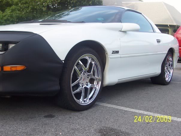

265's is what the guy wanted to put on there last time i got tires so i told him to go ahead.
I think they were about 125/each plus tax.
They dont look too bad, they seem like the could be a little wider...They are basically flush with the lip of the rim.
Here it is what do you think?

265 is a pretty narrow section width for a 10.5" wheel. I'd put more like a 295 on something that wide. It's not going to be cheap, though.

I have 10.5 in the rear with 295's. The fit perfect, no bulge. I really dont know how you could have 265's that sit flush? There isnt enough tire to properly cover the rim.
Get over the fact that some good tires will cost you 700-900. just bite the bullet, as i said before, they will improve 1/4 mile times, handling, braking, ride quality. A good set of tires will improve everything, and a **** poor set will bring down everything.
The decision is up to you.

that picture above is of 265s
