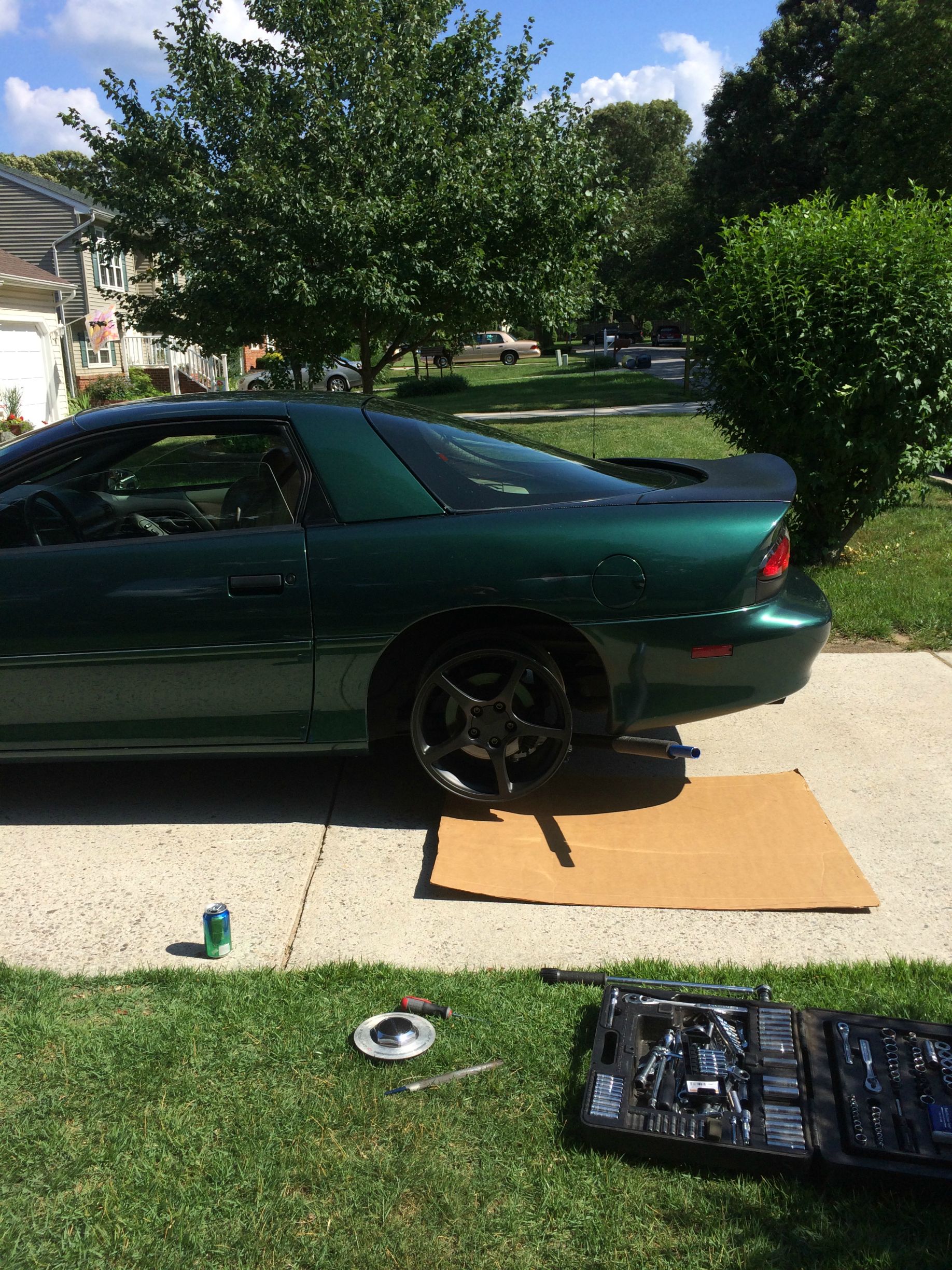

2. Test-fitted the wheels on the car
I only have a picture of my rear-wheel on, but I think they are going to look really great on the car, especially black! I had to grind some of the metal off of where the wheels go over the hubs so that they would easily slide on and off. After doing so, they fit well and the wheel clears everything, but as I mentioned earlier I might have to bang in the bottom corner on the inside of the wheel-well.

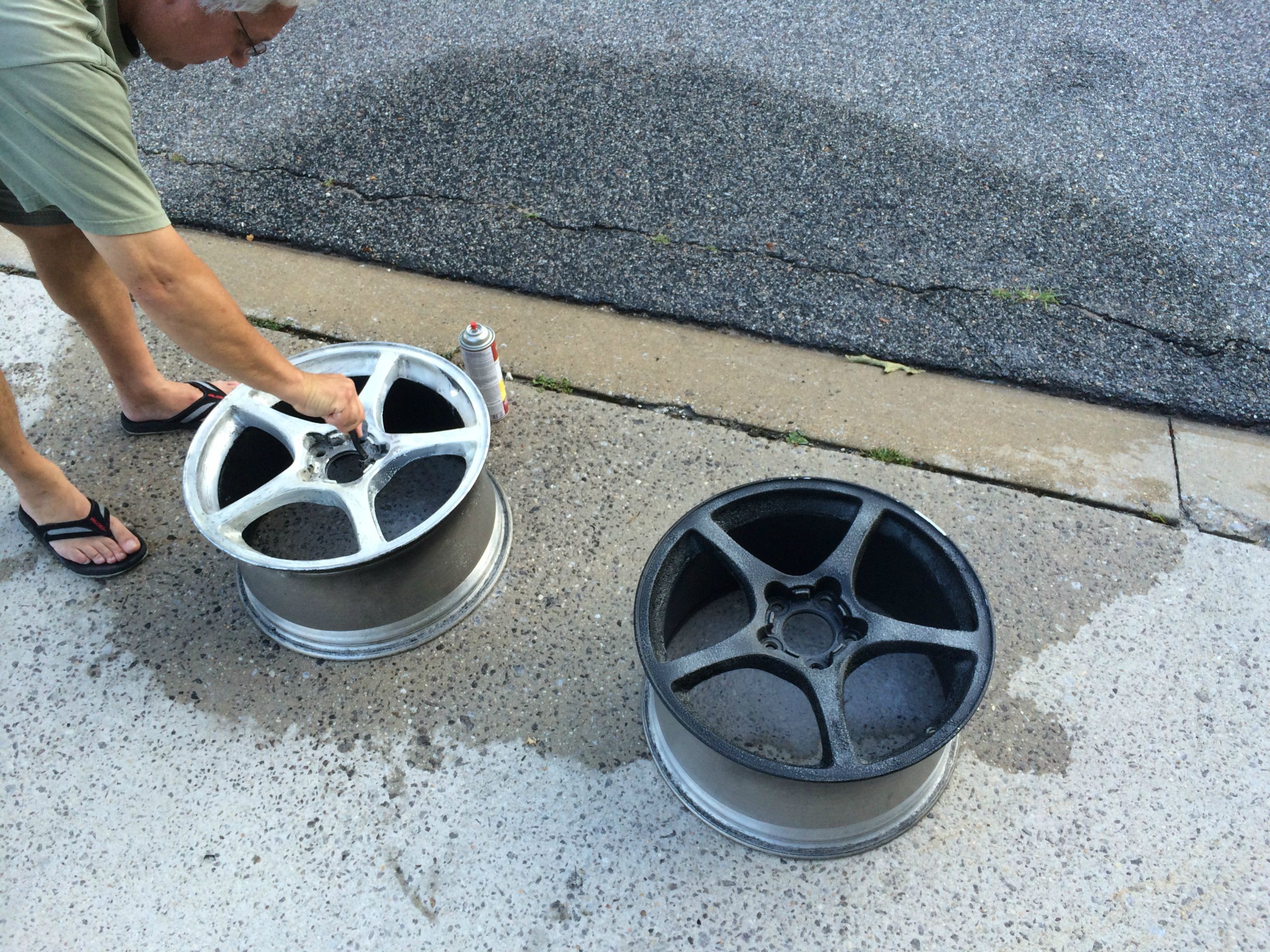

3. Stripped the pastidip off of the wheels
We have only the back two wheels done, but here is a photo of my father and I stripping the wheels back down to bare-metal. We would have left them alone, but when I was test-fitting the wheels earlier that day, some of the plastidip started to peel. Instead of just doing a "band-aid fix" (re-coating in plastidip), I decided that I wanted to strip them to the bare-metal and get them properly painted so we wouldn't have to worry about anything peeling again. That plastidip is some nasty stuff!
