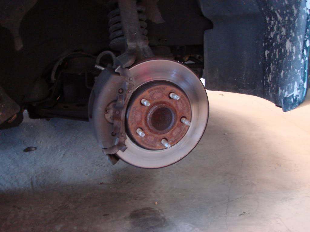

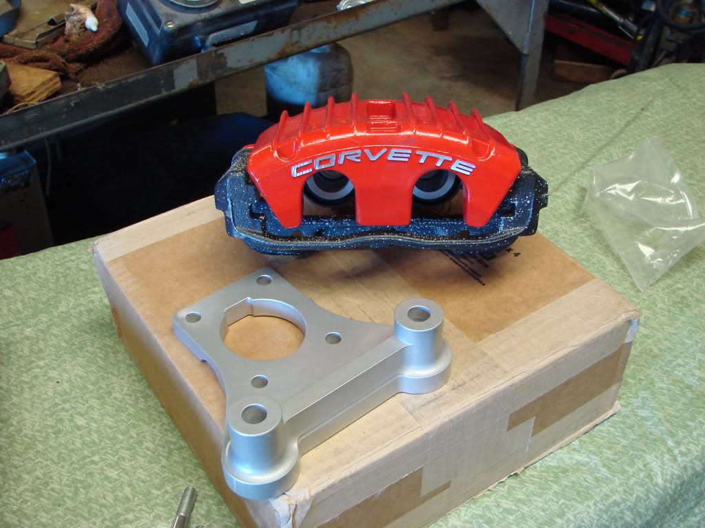

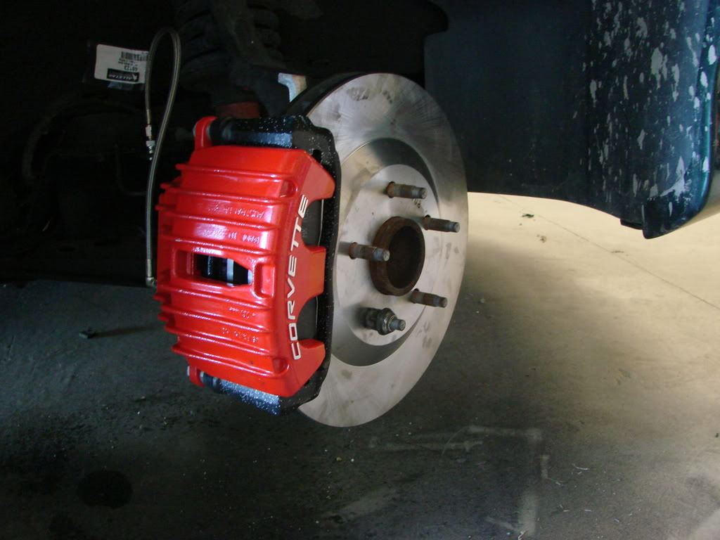

eye candy for anyone interested
last pic is w/o pads....just checking for any possible clearance issues before I paint the spindles.

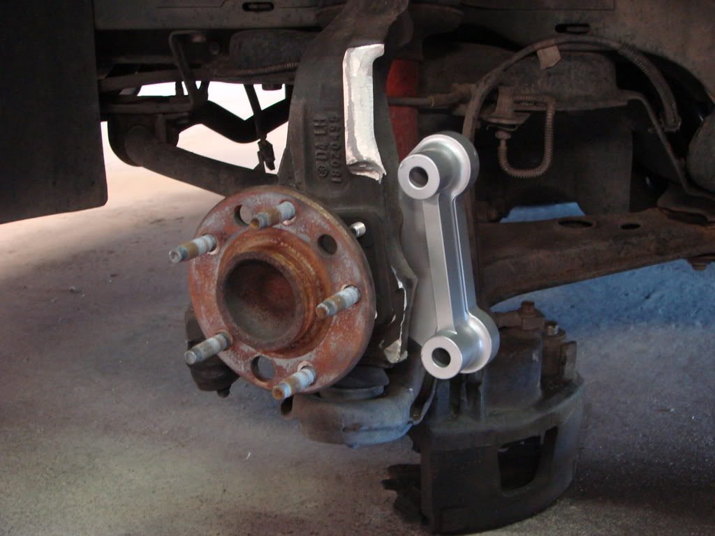

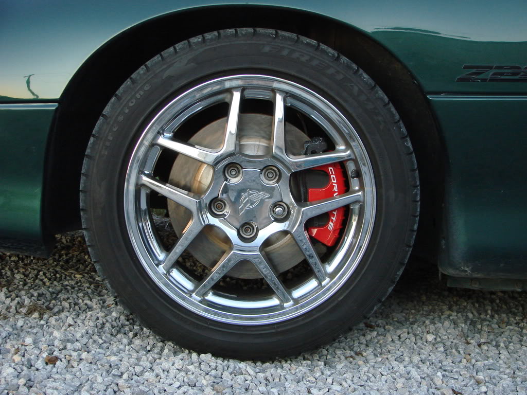

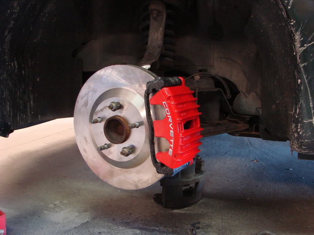

Couple more pics before and finished
I chose the Akebono (sp?) ceramic pads for the low dusting and they are rated as the poorest pad out there as far as stopping power goes. Even with the weak pads, the difference between the LT1 and the C5 brakes are incredible. Absolutely effortless braking power now
