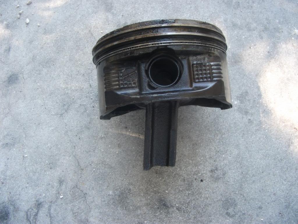

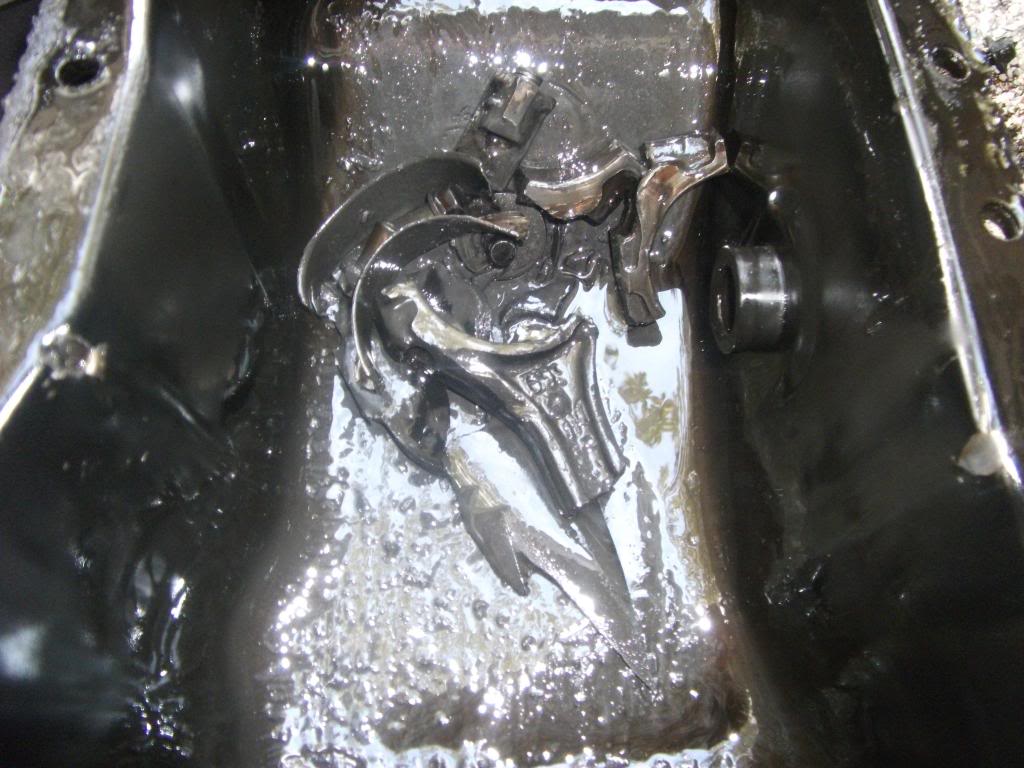

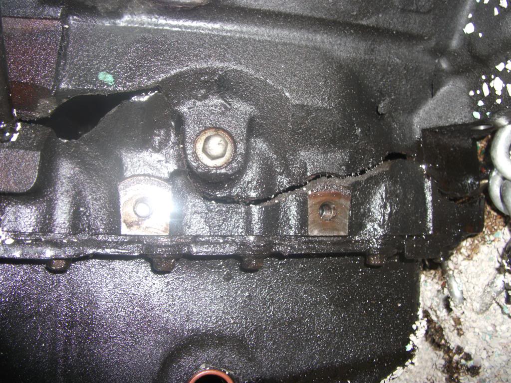

You now know of a N/A, unmodified 3.8 that grenaded hard! Split the block in half and everything! Was in a 1997 firebird I bought. Replaced the whole motor for 700.00 with one that looked rebuilt.
The car actually ran with motor like this as well. Guaranteed it never saw boost or nitrous
awww snap! thats crazy, i sure hope that doesnt end up happening to me lol. ive been taking it easy on her though, i went ahead the other day and replaced all the vaccum hoses, connectors, elbows, etc... I can def. tell its running a little bit smoother. ive always noticed my z28 has rediculously good power, so when i got this 3800 i kept telling myself not to expect much, but ive gotta say, when I open her up its not horrible low end seems a little slow but once i get up thereim a little bit more impressed than i thought i would be. oh yea, i plastidipped my hood yesterday because my clear was peeling realy bad and it was bugging me and ive gotta say it came out great, im extremely happy.
