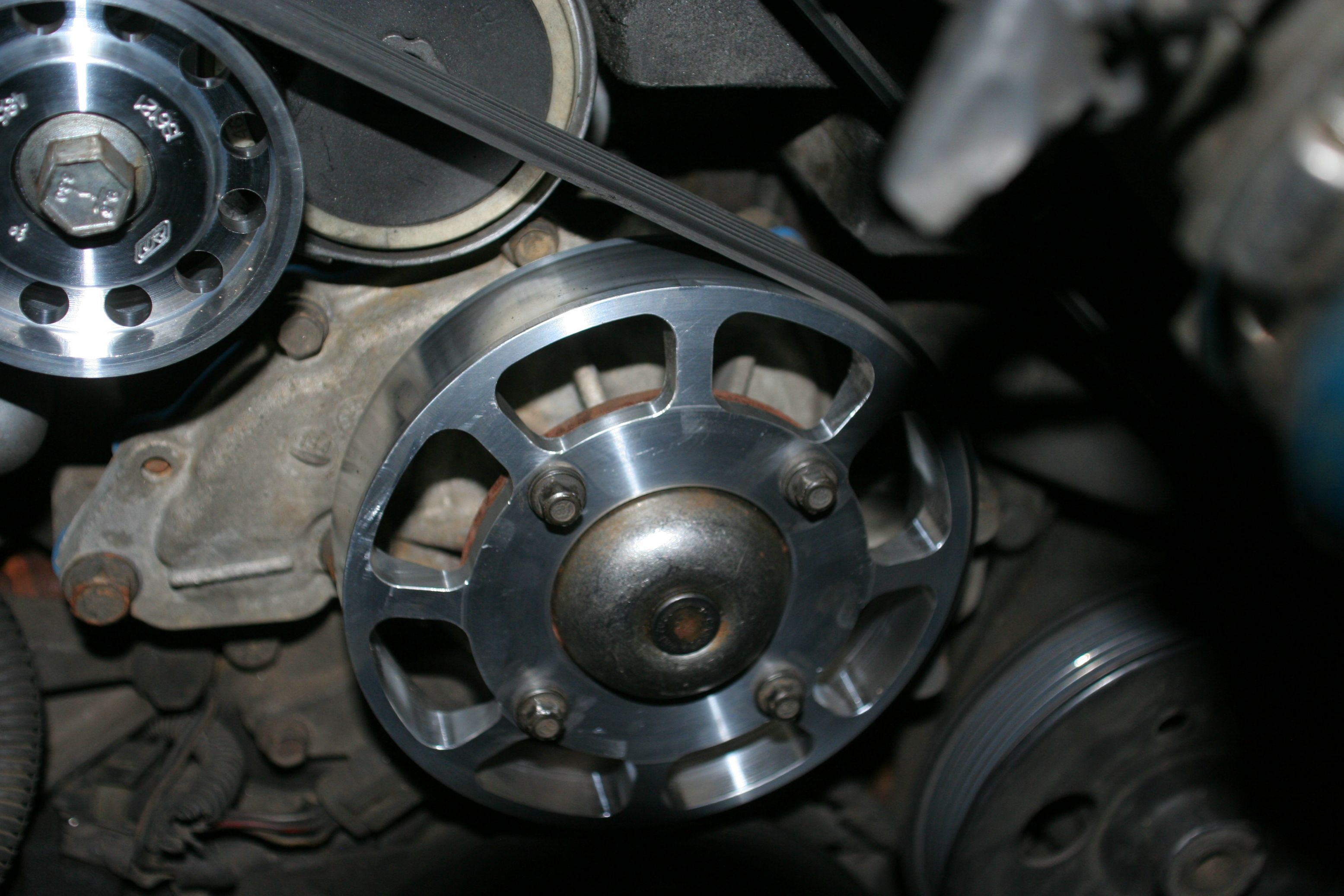

Made up a new part for my car yesterday:
8.5% water pump underdrive pulley, 0.75lbs lighter than the stock one too. Should net 2-3rwhp and a slight bump in mpg.

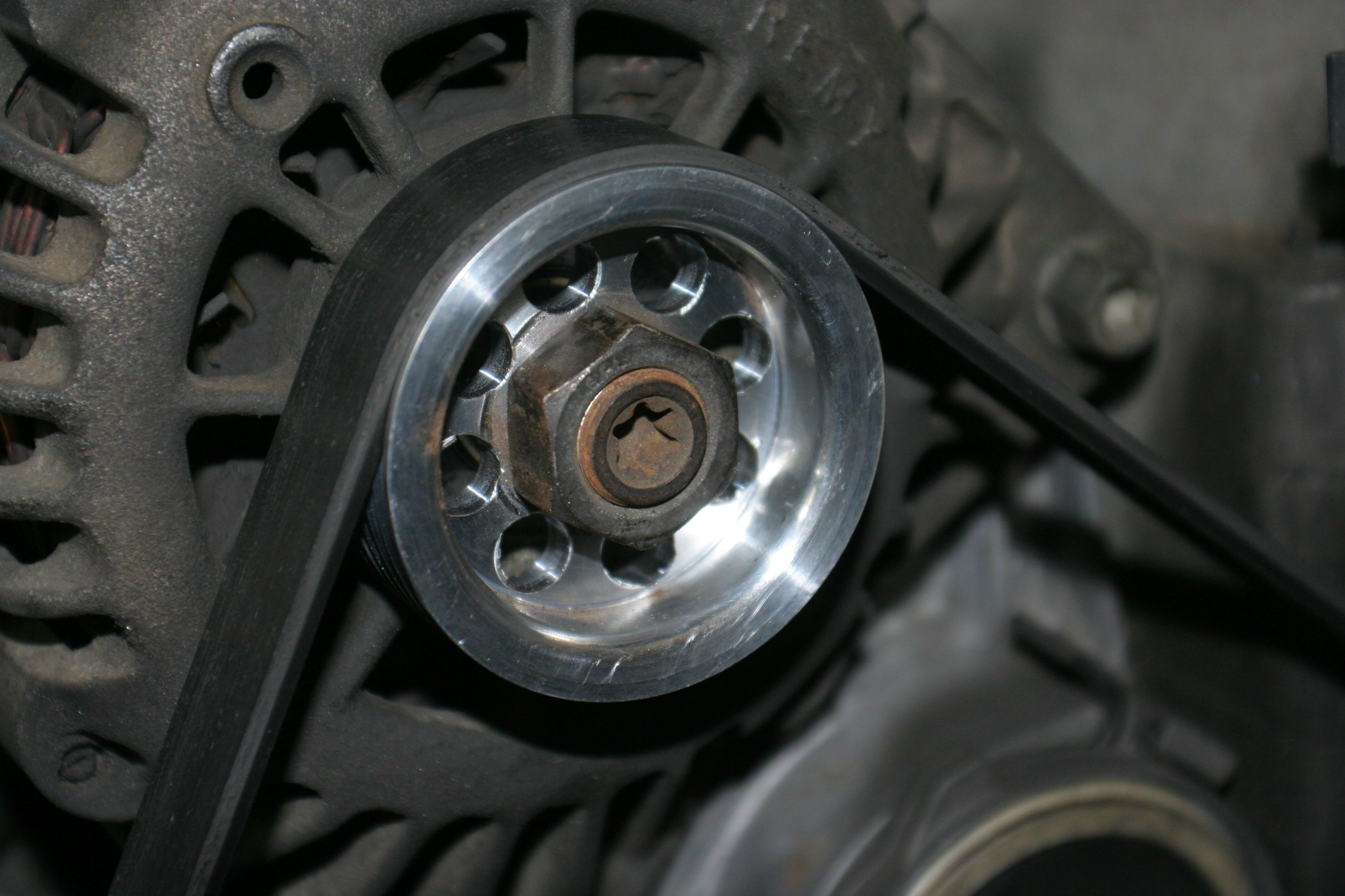

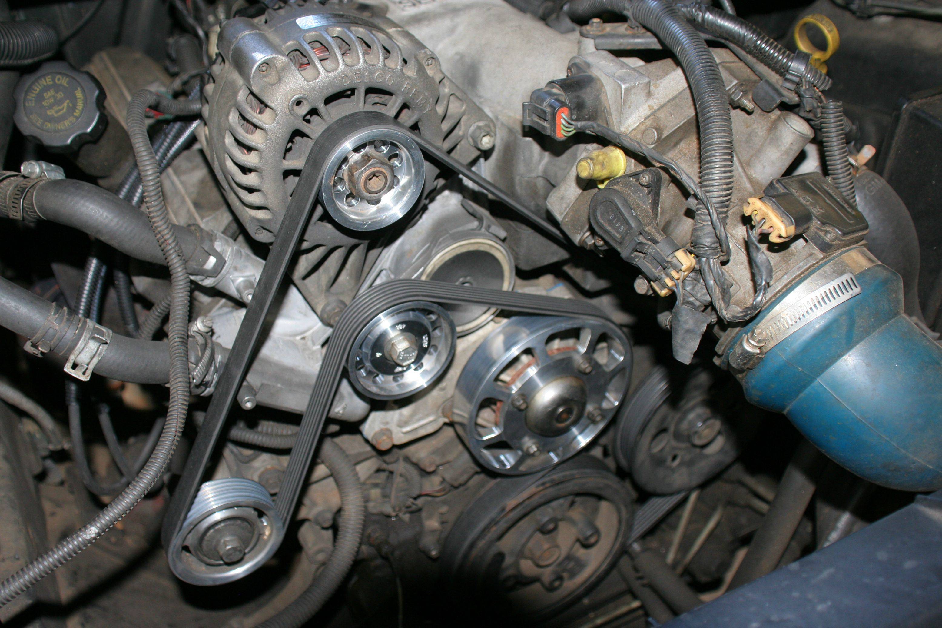

Had more time than I expected today, so I went ahead and made an alternator pulley as well.
It is 128 grams lighter than stock.
When it is all added up:
Water pump = 340g
Smooth idler = 60g
Ribber idler = 175g
For a total of 703g or 1.55lbs of rotating mass reduced.
