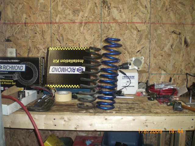

Here is a pic of the Eibach vs. stock spring. The Eibach is almost 2 inches taller.
I think the AGX shocks are shot. When I push the rod in, it comes out very slow. Much slower than stock, no matter where the shock setting is set at.
With the Stock shock and spring back in, I can't get the suspension to bounce using the UMI arms.
I had to remove a seized, and I mean SEIZED bolt in the lower control arm of my stock unit. Once out, I bolted up the stock lower and stock upper arms and now everything will compress.
I DID change the settings from UMI so I need to somehow try and get back to their settings and try this all over. The instructions don't say that they are within 1/16th of factory specs, which would have been helpful. I didn't change them much but at this point I am very puzzled as to why this isn't working out.
