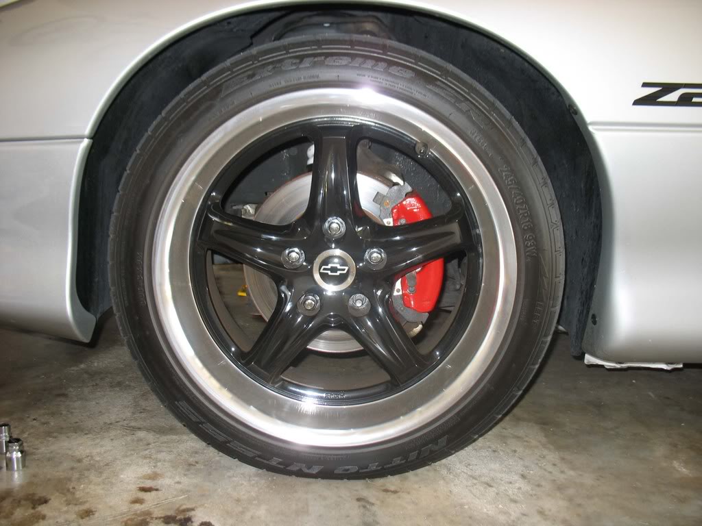

Before - Name:  BrakesBefore.jpg

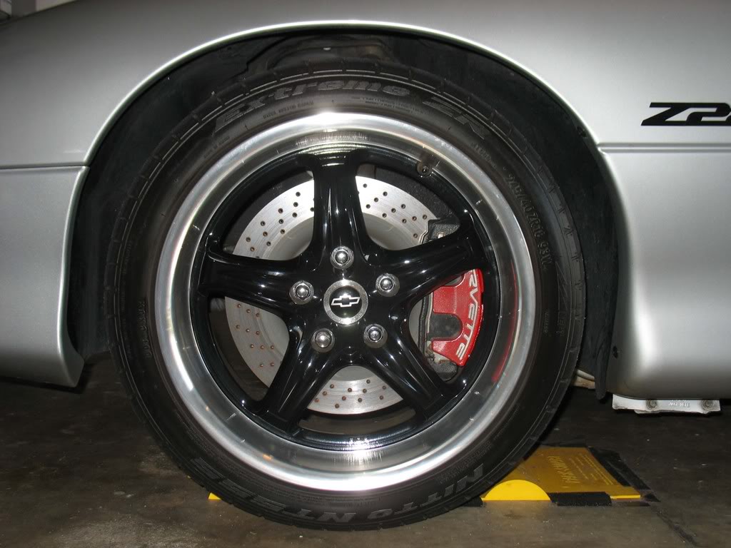

After - Name:  BrakesAfter.jpg

Pretty drastic difference, I'm sure your braking has much improved. Were there any pitfalls to doing that conversion?

I had to do a lot of grinding on the caliper because of the wheel. Had it been an 18" Z06 rim it would've been no problem. Since I have such a big lip, the 5-star was pushed further inward. It's a simple install really. All you need are the caliper mounting brackets, LS1 brake lines, new rotors and pads, and the tools.

It's night and day, I couldn't believe the difference.
Besides the calipers (which I got through a friend) here's the breakdown -
Caliper brackets - $90
Rotors - ~$230
Pads - ~ $80
LS1 stainless steel brake lines - ~$60
4 caliper mounting bolts, 8 bracket mounting bolts -~$25
