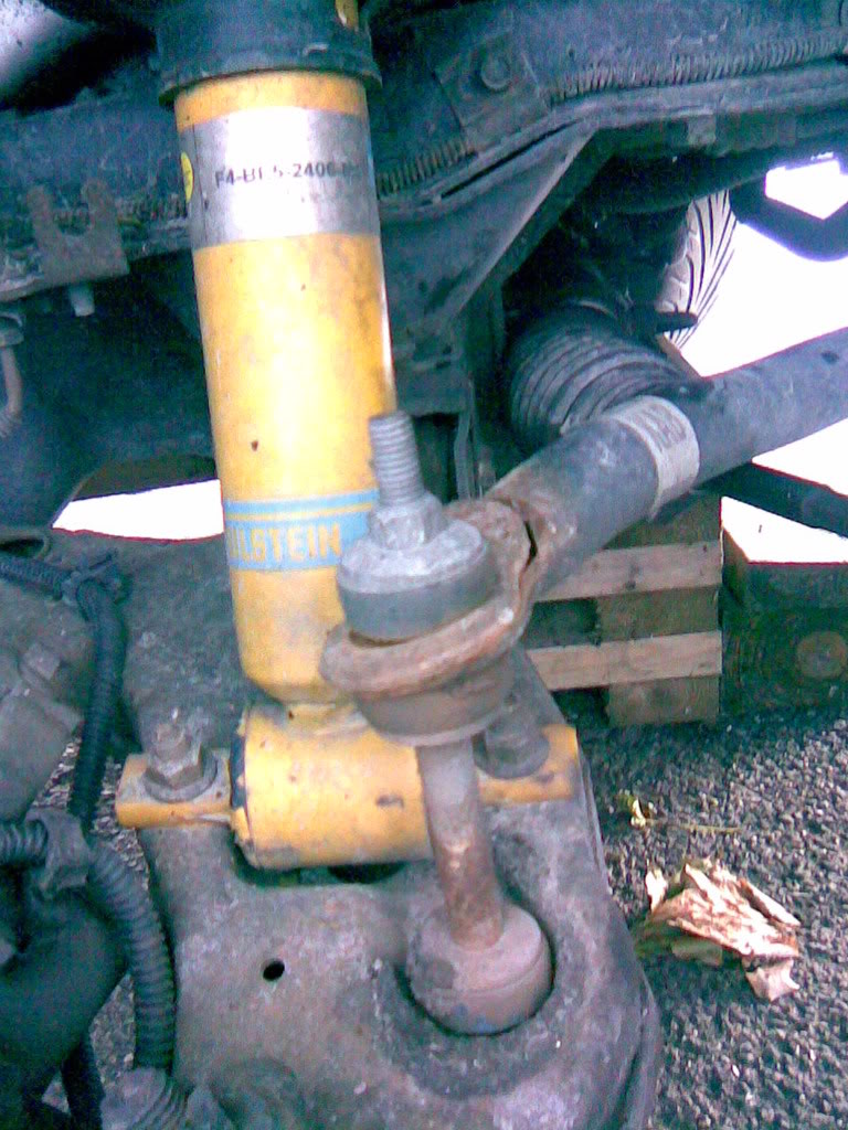

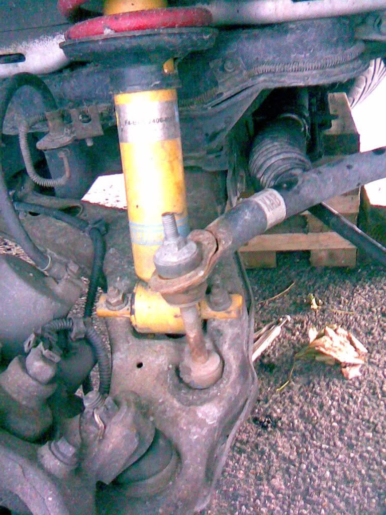

I was installing some new bushings today and I noticed this.
Look how the end of the sway bar split. What could have caused this?
What would you recommend to fix it? Could it just be welded? I really hate to spend any more $ buying a new one. I am looking locally for a new one but havent had any luck yet.

I would buy a new bar. It might be cheaper than having it repaired.

I'm no scientist but my guess is that it was caused by force acting on a sway bar weakened by old age and corrosion.
Hit the junkyard, they should have plenty more. Or spend what it takes for an aftermarket bar, it's well worth it.

I work at a tranny shop, and take sway bar links off all the time to pop the balljoint. I see that same thing on i'd say 1/3 of gm cars, must be a weak point. But i would never weld a sway bar, would think you'd just be making another weak point, just replace it.
