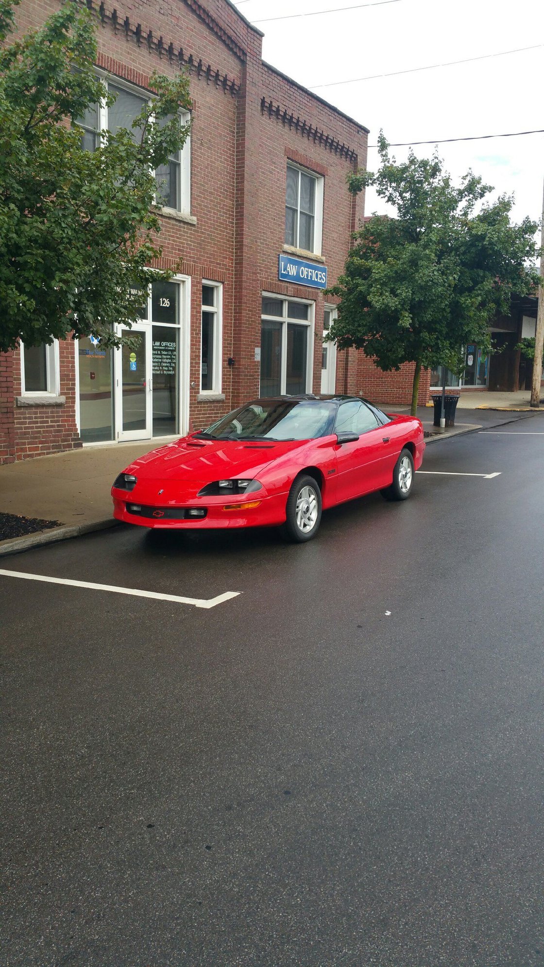

I recommend Moog CC635 and 60116. The 60114 is the LS motor (weighs less than an LT1) and V6 spring Moog lists for everything. The 60116 is the 00-02 WS6 and SS front spring a better option for the heavier nose of an LT1 car. I put the 60116 and CC635 on my 94 with Bilsteins. The ride was night and day vs the stock springs and DeCarbon shocks.
