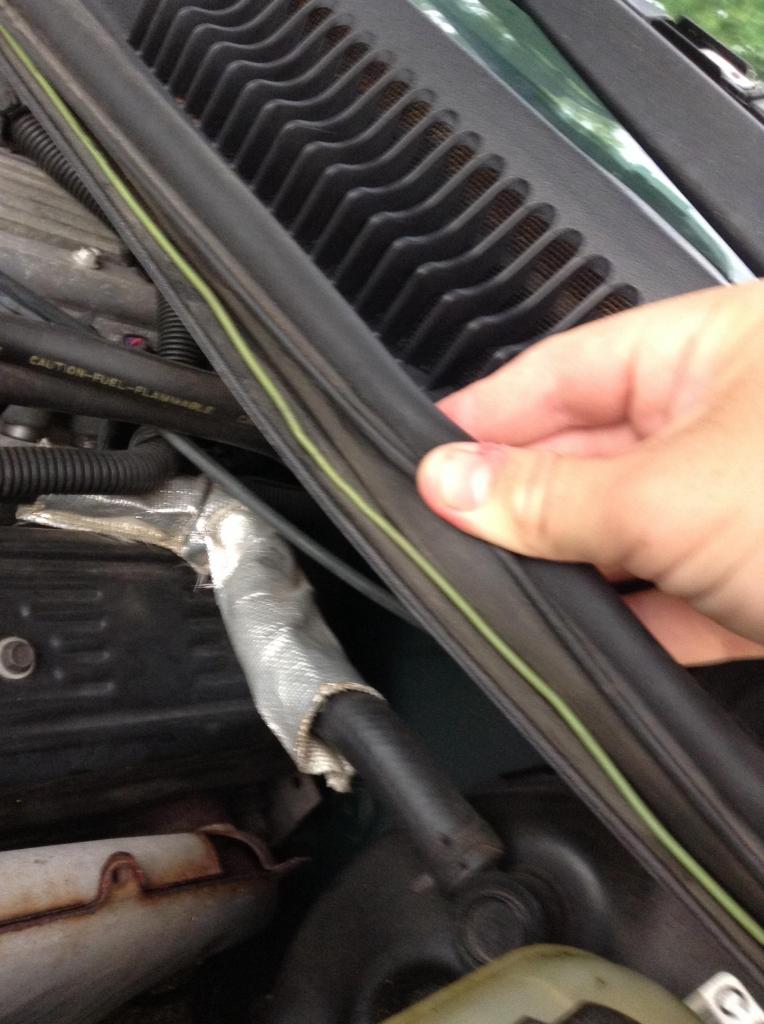

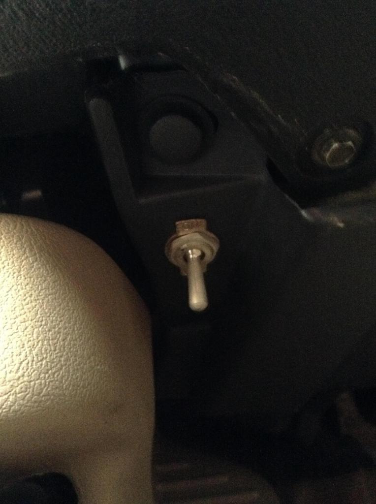

Today I got a little fed up and removed the wired protector (black piece around the wires).
I saw a light green wire spliced with my dark green wire near my pcm. I traced the light green wire as it should not be there.
It goes through the fire wall and meets up with a switch under my dash. Just an on off switch. (I had always wondered why that switch was there and what it was)
So now I'm assuming someone rigged up my cars ac so they could turn it off/on but ended up making more issues than not.
I will post pictures in a second

Can you see where the green wire with white stripe goes? It is either to the PCM or to the fuse/relay box. C100 is where it was evidently. Can you see what pin number it came from? That is the connector in your next-to-last photo.
It looks like the added switch controls the compressor relay by connecting a ground to the green/white wire, perhaps because the switch for the ac became unreliable. If that was the case, the switch could be intermittent. If it comes on when the relay isn't enabled, that would set code 69 because the pcm, would expect the relay to energize. And without that line connected to the pcm, it would always set code 70.
You could prevent both codes by disconnecting the green/white wire from the HVAC control to the pcm. But you have to know that by using the added switch, you are bypassing important safeguards in protecting the compressor if it is low on refrigerant. Also there are times the pcm cuts off the ac for other reasons like overheating and low or high rpm.

just to keep everyone updated on this and as a reference for anyone having the same problem.
I pulled the pcm and found that the spliced wire was cut at the pcm. I connected the wire back up and the compressor turned on as soon as I started the car up.
the ac works now but its not super cold. I think it needs a recharge, but it is at least working currently.
