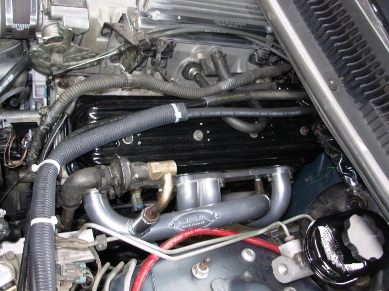

when I move this hose to the brake cylinder out of my way, like bend it in the middle:
It makes a hiss, making me think its cracked somewhere under the heat wrapping....I guess I need a new one but I can't figure out what it's called and can't find it.
(note - the green arrow is hard to see).
Old Jun 13, 2009 | 01:13 PM
Posts: 71,109
That's the vacuum line for the brake booster. Check at the plastic piece the hose attaches to, that is pushed into the grommet on the brake booster. Its usually pretty loose, and will leak if you push on it.
