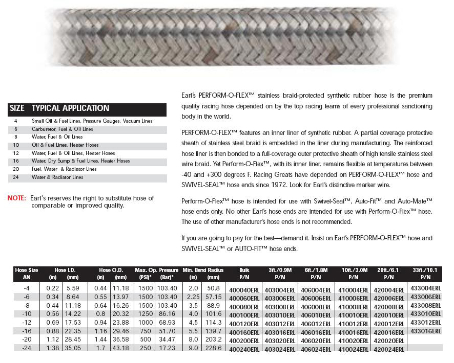

Im doing it on my car, I have fittings to weld to my rad and water pump, but my question is for those of you that did it what for angle ends did you need? I dont have my engine in my car right now so I cant tell where my WP sits for sure, I can only guess and at the price of fittings for BIG AN lines I dont want to order the wrong ones, I know on one of the message boards Im on someone did it but I dont remember witch one.

yes its still rubber underneath but there better rubber its even made for fuel use up to -2an and braided line keep them from swelling so they dont blow out, I need custom lines since the rad I got has diffrent fittings on there than my pump, Im ont a fan of the conversion hoses to step the size down I have those hoses here I paid 60 bucks a piece for those and there not worth a dam. really once you have all the fittings the only thing that cen go wrong is the hose I can do my main rad hoses with 1 3 foot peice of hose, thats 60 bucks, its the fittings that are expensive, I want this thing to look nice and never have a problem, I spent so much money on this car what another 500 bucks for hoses that will last.
I already have hoses and some weld in fittings for the job
