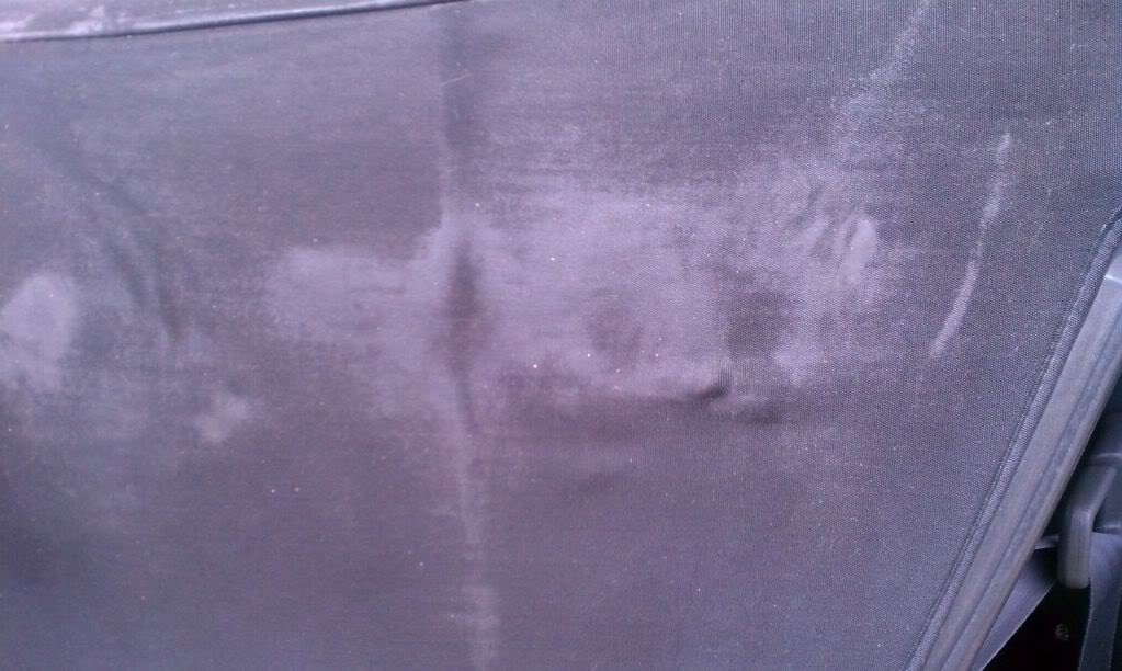

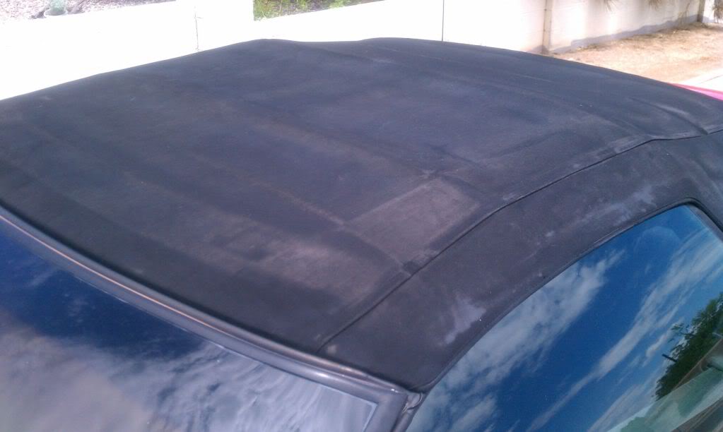

Here are a couple pics, a close-up of the odd black spots and of the difference with regular dirt (from a dust storm yesterday) compared to the black areas near the driver's side window, respectively:

Old Jul 12, 2011 | 09:33 PM
Brangeta's Avatar
Joined: May 2002
Posts: 5,557
From: Dallas, Texas
Re: Restoring sailcloth convertible top
Originally Posted by WakingUpMy97
Too bad none of us thought to vacuum our old tops before we tried to restore them.
Thanks for your valuable input, Brangeta, and for treating me like an idiot.
LOL! I'm sorry.
I just think it's weird that when it comes to cars, people don't (for example) vacuum the leaves out of the engine bay and etc. like they would carpet. The solution is always to spray something on it and then pressure wash.
At this point, I'd probably try dawn dish washing soap to remove any grease and then rinse it really well and see how it turns out.
Old Jul 14, 2011 | 12:20 PM
WakingUpMy97's Avatar
Joined: May 2011
Posts: 42
From: Albuquerque, NM
It's all good, I'm sorry if I was overly defensive. The first thing I did when I got my car home was vacuum the rat sh*t off the intake... I agree that getting rid of the big stuff before deep-cleaning is integral. What really got the dirt out was light duty carpet cleaner. I'll take 90% improvement over nothing lol. I really think the greasy looking spots are just worn down cloth now. Next thing to try is replacing the old vinyl window with a new glass one. Fun... lol
