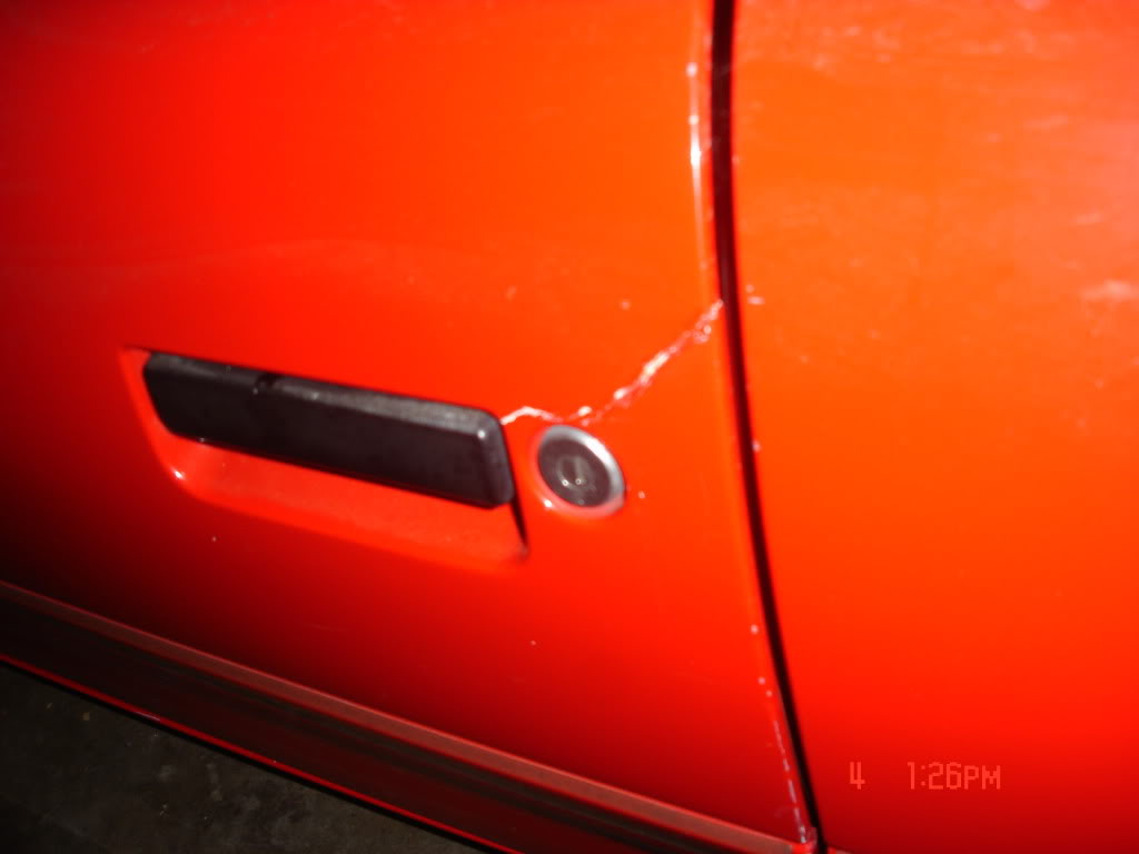

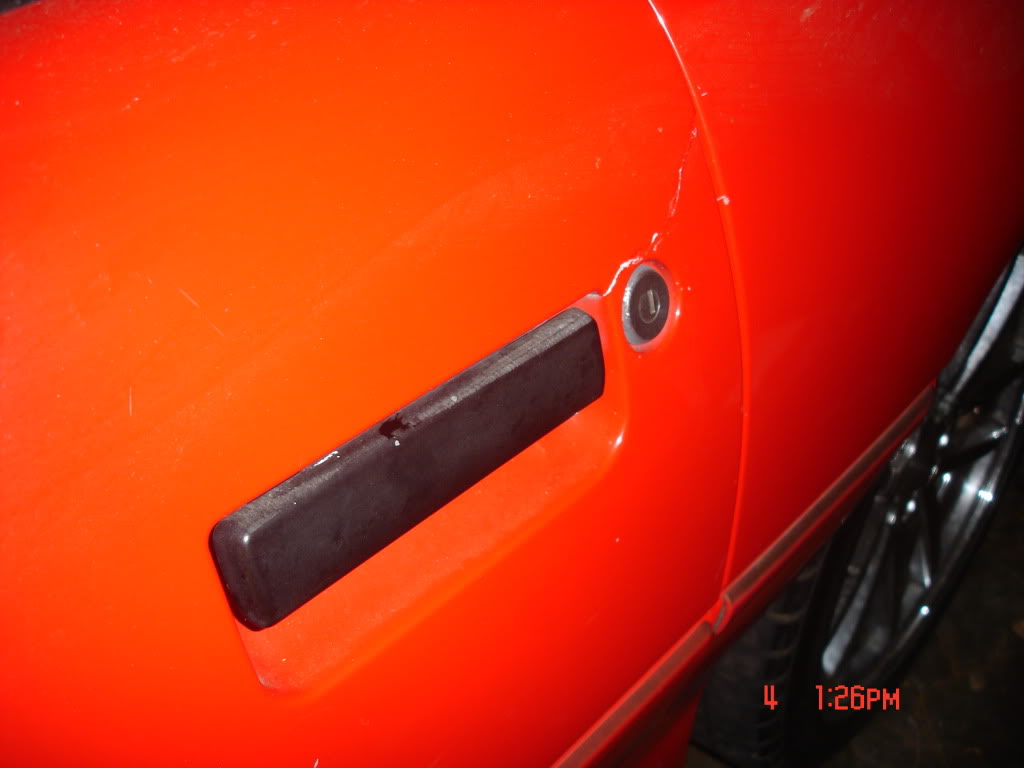

Does it look like this? This is my crack on My 1994 Camaro Z28. I bought the car like this, I have never got around to getting it fixed. The doors easily crack since its made out of Fiberglass. Some of my friends never even notice the crack until I told them, and this is years of me owning it.

its worse it goes out ward like that but the downward also, all because i accidentally tapped the garage wall, i've realized they crack easily too i will have a pic up tonight just got around to taking one but i'm currently at work
