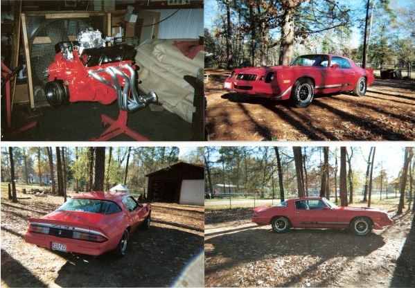

Just rebuilt the Super T-10 in that Z and almost got the 5th engine finished, which is a low filled right hand dipstick small block with Dart 200cc Iron Eagles Ferrea 2.02 intake and Manley Race Master 1.60 Exhaust valves Crane split duration roller cam which I usually don't say too much info more than that about the cam, but it has 1.5 Crane roller rockers over it. along with SRP 4.040 flat tops, Eagle 6" rods and a steel 3.750 crank 10/10 under Tricked out 830 cfm Rochester that has been ported even more with a 1/2 inch fuel line all the way to the sending unit in the gas tank!
Won’t run a Holly, what for? It’s easy to make power without one. Maybe if I had 900 hp but then all I’d have to do is run dual Rochester's so I still wouldn’t have to have a Holly. Had ‘em before and WAY like the Rochester better. Huge secondaries, easier to rebuild and what most people don’t know is the huge number of circle track racers that use Rochester's and win 1st place. I know some of them. You guy’s that have Holly’s, not bashing you, glad you like them. I just don’t want one and I’ve spent thousands of hours in a machine shop building race engines.
The car is hundred’s of pounds lighter than stock and there are frame connectors and traction bars. Replaced the power steering with a manual box, soon to be replaced with Rack and Pinion.
Both the Upper AND Lower grills now flow air since I cut out the lower grill and installed 1/2 of an upper grill to it making it look factory, and now it flows.
Took OFF the front spoiler making the car LOOK LIKE a 1978 instead of a '79. Don't need the air dam since both grills flow and I never did like the way that front spoiler looked anyway with those big lugs on each side of the car. Not only that, there was absolutely NO DIFFERENCE in the way the front end handled at high speed with or without that front spoiler and I drove it each way. Didn’t feel any difference.
3.73 limited slip rear and the red line or I should say the rev limiter in the 6 AL box is 6800 and it pulls HARD all the way up to 6800 in every gear. except 4th because I don't want to go 155 mph.
