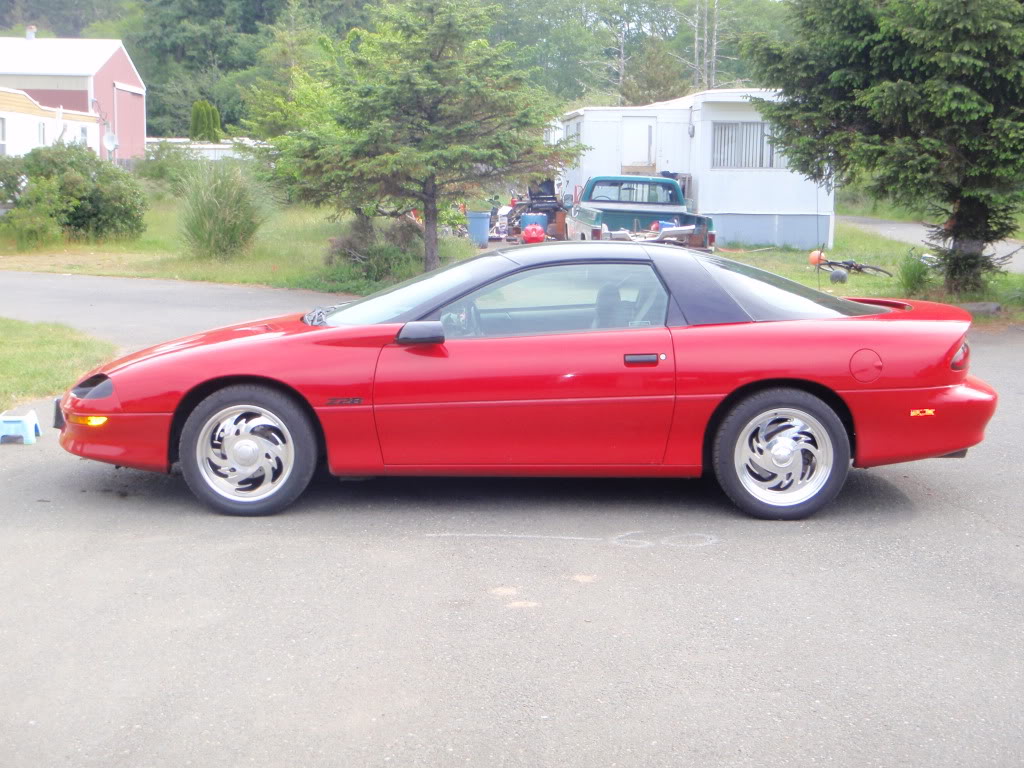

hay guys and gals hope all is good with u all. ive got a 93 z28 that i have been workin on.

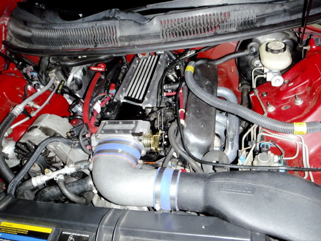

heres whats in it so far;
Intake
fully ported
enlarged runners
58mm tb opening
58mm bbk throttle body
LT1 LE2 heads
manley 2.00/1.56 6000 series valves
patriot gold extreme springs (155 lbs seat and 400 lbs open)
205 cc intake port
flow about 275/190 CFM
bullet racing cam grind #CLT276/281-12HR
223/230 .565/.565 112 separation
single roller timing chain with gears
aluminum billet oil pump drive housing
comp cam roller rocker arms
1.6 7/16 pro magnum
tpis performance roller lifters
GM performance composition head gaskets
part # 12553160
.028 compressed thickness
gm performance oil pump NAL-12555884
5.5 qt moroso oil pan 20185
arp oil pan studs 234-1901
arp main bearing studs 134-5601
moroso oil pump pickup 24212
rpc valve covers
kooks 1 3/4 x3 headers jethot coated
kooks catted y pipe jethot coated
transmission
700r4 raptor level 3 transmission
raptor drive upgrade
power gear 6 pinion upgrade
5x power raptor lockup converter 2000 stall
msd vented opti
msd blaster coil
8.5 mm msd plug wires
