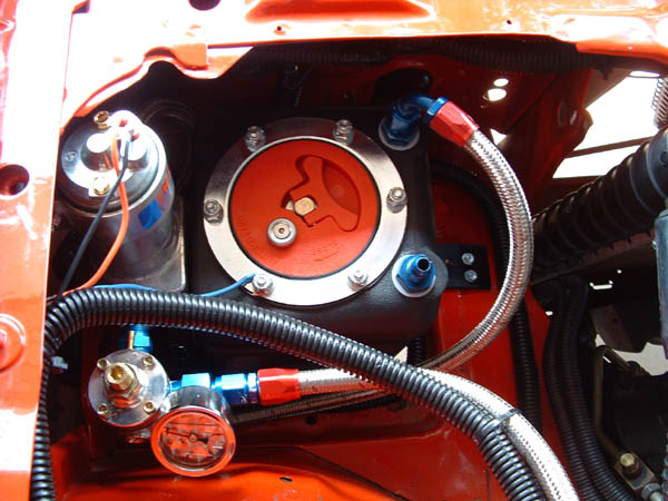

Here is what I am doing:
1 gallon jaz nitrous enrichment fuel cell in the engine compartment
Holley Blue pump with a holley regulator with return line to fuel cell feeding the fuel solenoid
Holley 110 gph mechanical fuel pump feeding the carb
Cheap and easy, and you will have a nice dedicated fuel system. Also, you can fill the 1 gallon fuel cell with some potent race gas .

This I know... the race gas thing... I'm currently running low 11's on 175 shot on a stock bottom end.. lol How large is your return line??? Do you have any pictures of your dedicated fuel system??? I would love to see them...
Its all in pieces in my room at the moment, but I have a pic of what I am copying:
http://www.thirdgen.org/techbb2/atta...postid=1442150
I planned on running a -6 AN return.
How safe is that under-hood setup?
Is it more efficient than running a second line from the gas tank?

Hey 12second3rdgen, what kind of fuel pressure regulator is that???? It is running a bypass, correct??? What exact parts did you buy????? I appreciate it...
In the picture that is a mallory 3 port regulator. I will be running a holley $22 3 port regulator (the one that comes with the holley blue pump). You want to run a return so that you dont get air in the line before the fuel, otherwise you will go extremely lean whenever you first apply the squeeze.
