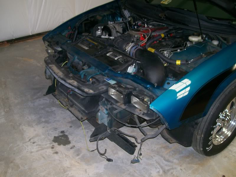

step 1: remove the front bumper,and bumper support bar, there are quite a few plastic expanding clips and 4 hidden bolts (4 7mm bolts right under the headlights one under each) the rest you should be able to see and remove with ease. (yes the bottom beauty covers have to be removed)it helps to have a friend remove the bumper with you, but i removed and re installed mine pretty easy. (now would also be a good time to delete the bumper bar for weight savings) when your done it should look like this:

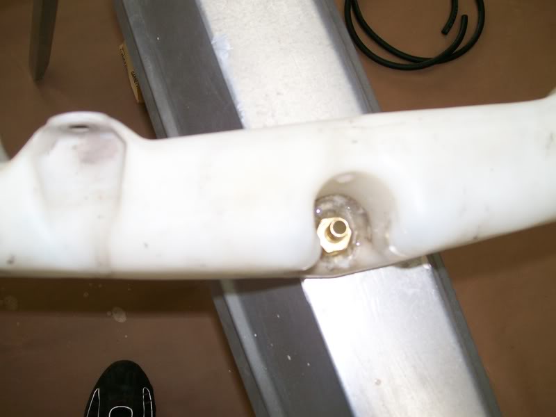

Step 6: remove the washer Resivor. there will be 4 push clips in the resivor, an electrical connector to the pump and a nose for the fluid. disconnect these and tie them up out of the way. NOW grab a torch and the last 3/8 barb (like used in the pump), remove the pump from the resivor and all fluid still in it, pull the rubber bushing out also. now the fun part, turn the torch on and light it up,on LOW, heat the small hole up where the pump mounted just enough thats its mailable, use your 3/8" threaded barb and while the plastic is soft, push the fitting into the hole softly and thread it in 1/2 way just like you would do in any other material. now dont waste any time, thread the barb BACK out and let the plastic cool for about 5 minutes. when its cool to the touch, mix up a some more 5 min. epoxy, put a good amount on the fitting and thread it in a little ways, let it sit for about 30 seconds (to let the epoxy cure so its not so thin). after a few seconds have gone by, thread it the rest of the way in, then mix some more epoxy and put a good amount on top where the fitting was just threaded in. MAKE SURE ALL SURFACES YOU PUT EXOXY ARE CLEAN! it SHOULD look like this HERE
HERE
Step 7:connect the pump to the resivor (from now on refered to as the tank) use about 2 ft or so 3/8" line and 2 worm clamps DO NOT OVER TIGHTEN THE CLAMPS! DOING SO WILL DAMAGE THE LINE AND CAUSE LEAKS LATER ON DOWN THE LINE! anywhere the hoses hit a metal edge that was sharp or could cause wear, i sliced a vacuum hose (11/32" i think) down the middle and put a few dabs of epoxy on the inside to aid in holding it on the metal like THIS
HERE
HERE

added bonus:i decided to make a vent tube setup...all i did was buy 3 ft of vacuum line and a 90 deg fitting, drilled 2 holes and epoxied it in the top and blocked off the vent hole in the tank cap to prevent fuel overflow under the hood. so i ran the vent tube out to the bottom under the nose
HERE HERE and HERE
HERE HERE and HERE
