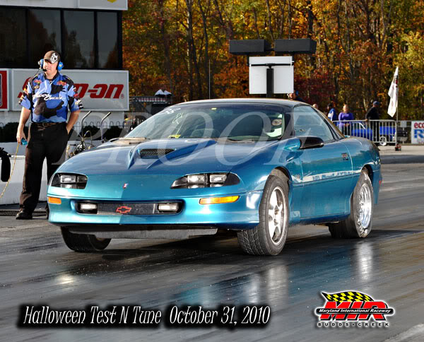

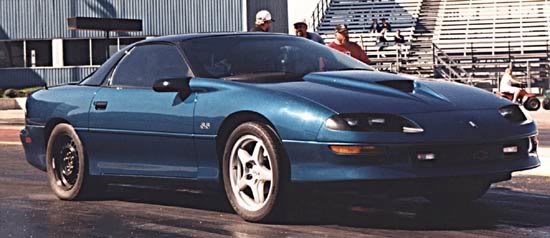

Tracked down the photographer.
I'm ashamed to put up a higher resolution picture since the paint is so hideous.

I am surprised it left so flat. I was hoping for a more aggressive stance. It looks no different when I was cutting 1.8 60' times.
