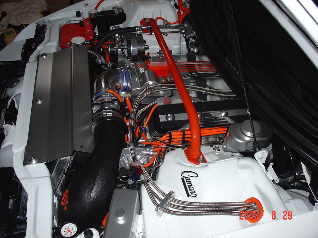

I have these on my 95, and they fit great. No problems. You do have to buy each part that shoebox listed. The PCV hose being on the side looks much neater. It's actually hidden beneath my fuel rail covers. I also have the OTC wires w/ this set up. I have pics, but no website. If you are interested, just send me a PM w/ your email.
I also have the ProMags, and didn't have any fitment issues. You also have to have the valve cover gaskets, shoebox has that PN as well.
It is expensive, but when done right, looks great. I had mine slicked down, and painted, so they are a smooth gloss black. I had also bought the MBA alum. tab inserts, back in the day, and they really dressed them up.
The alum. ones on ebay work just fine as well, its just that everyone is starting to buy them now...

Here are 2 pics to help w/ your decision. These pics are a couple of years old, but you get the idea.
http://i160.photobucket.com/albums/t...S/DSC00859.jpg
http://i160.photobucket.com/albums/t...S/DSC00858.jpg
