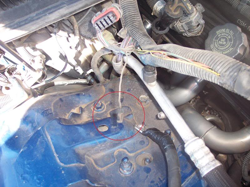

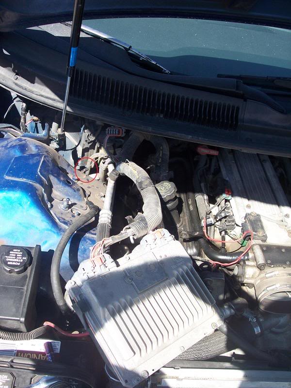

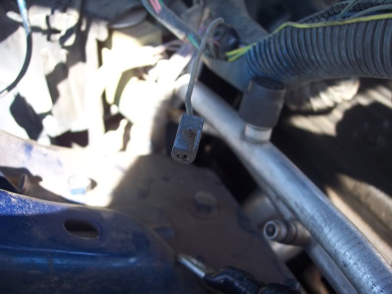

im in the process of pulling the motor and while pulling the wire harness through the fire wall i found this wire not connected to anything. just wondering what it goes to.

It does not go to anything. It's the fuel pump prime connector. 12v is jumpered to it to run the fuel pump for diagnostics.

oh ok thats good to know. i read your how to's and see you can use it to test for leaks. when you jumper 12v to it what is the process to get it? do you only have to hook a power wire from the battery?
That's right. A fused jumper is normally recommended.
