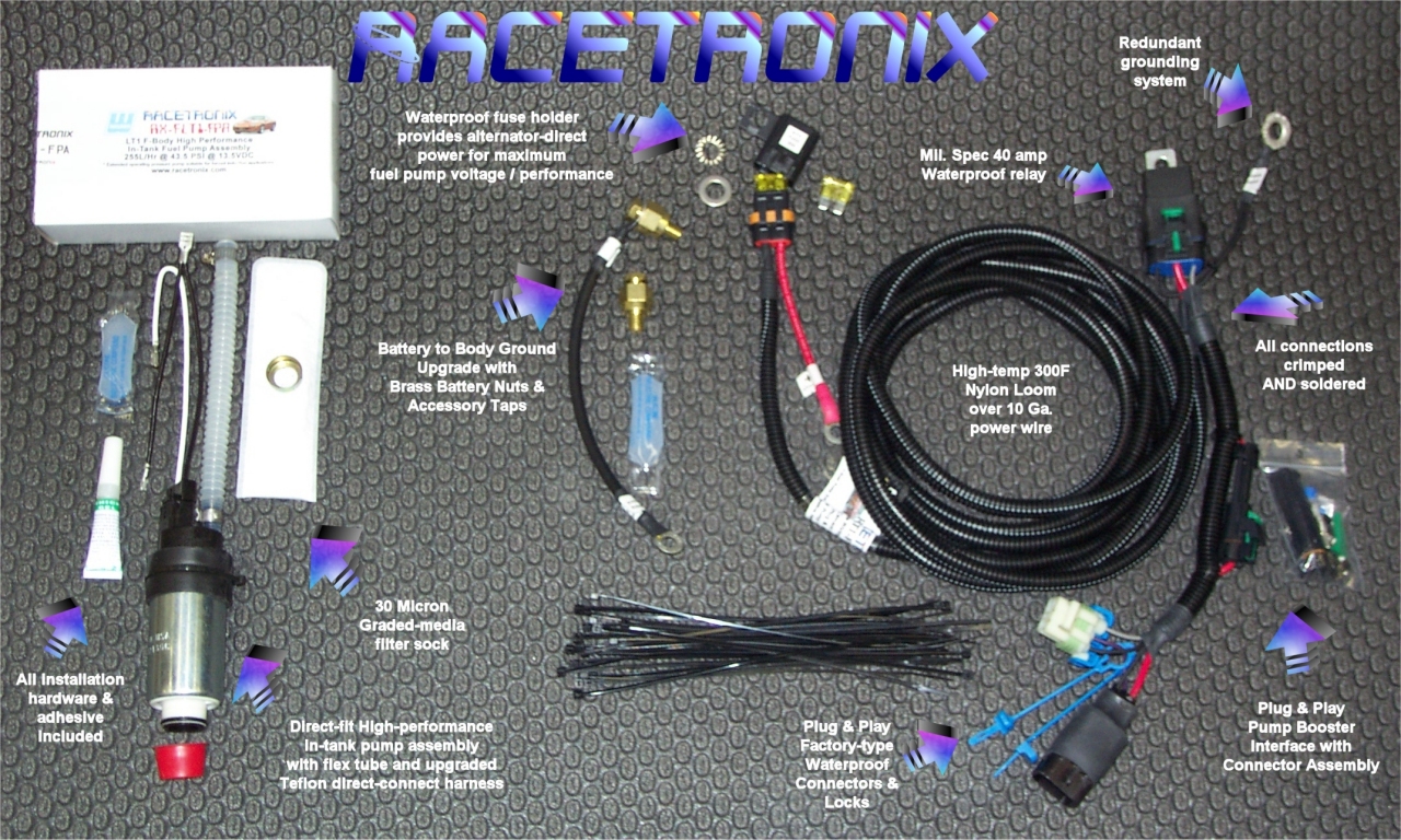

You have a lot to learn about the two systems before making such a bold statement. Does a rubber hose classify as a proper replacement for a flex tube? Does an in-line wiring adapter act as a replacement for corroded / burnt in-tank wiring. Does the old hard and dried factory sealing ring provide a proper seal in the bottom of the bucket? Does the filter sock have the same spec. and dimensions as the factory unit? Do these kits include gas compatible adhesive? ...........
We know what certain vendors have listed on their web pages but when you are not in the position to manufacture anything and all you have to offer is a re-boxed product well.... There are always people who will brag about how they got away with using brand 'X' vs. brand 'R' but until you have used brand 'R' essentially ignorance is bliss.
There 1000's of people on this and other forums who have bought the Racetronix F-LT1 system and they are the ones who can testify to the differences the Racetronix fuel pump assembly has to offer over brand 'X'.
http://www.racetronix.com/Racetronix..._Pump_Kit.html
http://www.racetronix.com/product/RX...LT1-FPKG-2.jpg

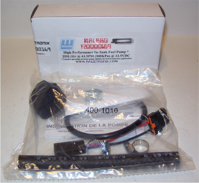

BTW please point out the missing filter sock you claim is not with our systems.
http://www.racetronix.com/product/Fu.../Dcp_3273a.jpg

I am just posting my research results. My bad for not seeing the filter in your kit; the picture you guys listed doesn't show one. You guys still have the best price for F200000169 kit, $20 cheaper than anybody else, and in this thread I point to a specefic location where to buy this kit-from you. This thread is intended for people to find the cheapest direct replacement fuel pump, not for better combo where you replace all the wiring. I never wrote that F200000169 kit is better than your kit, and I never even mentioned your kit. Although I gave thumbs up for the best price you guys offer on the F200000169 kit; I gave honest opinion in this thread about what I think of F200000169 kit. My brother and I are very happy with F200000169 kit, and I am letting everybody know that. By the way, I have masters in aerospace engineering from top five engineering schools in USA, I know how to do research well
It doesn't? Look again. All 400-1016 install kits have one as can be seen in the picture. As an engineer you should know that the details are everything.
http://www.racetronix.com/RX-F200000169.html

Racetronix has done much research and that is why we have an o-ring on the bottom of the pump which makes a liquid tight seal. This seal is very important so that the pump does not suck unfiltered fuel from the bucket which can cause pump failure. A Walbro gerotor pump is much more sensitive to contamination than a factory vane pump. This is why Walbro uses a 30 micron graded media filter sock vs. the factory 70 micron nylon weave filter sock.
The flex tube Racetronix uses is the same as the factory type and will not kink and swell like the rubber hose in the 400-1016 kit. Rubber hose is not compatible with today's fuel which is loaded with solvents and alcohols. When the F-LT1 systems were designed Methanol was not a common additive in gas. This is why the fuel systems in the new cars do not have rubber components. Using the rubber hose requires that the push-lock fitting be removed. The flex tube Racetronix supplies is expanded to fit onto the factory push-lock connector.
Many of the in-tank wiring harnesses are corroded and some are even melted onto the pumps. This is a common problem with the F-LT1 pumps. Using the in-line wiring adapter that comes with the 400-1016 kit retains the old factory wiring, adds an extra connection and length which equates to more resistance and potential problems.
The Racetronix system comes with gas resistant adhesive, a new connector and lock, silicone grease and the proper size 30 micron filter sock for the bottom of the bucket.
All these items in the Racetronix pump assembly are there to address real issues which arise on F-LT1 systems. Our research spans 100's of modules that Racetronix and our dealers have submitted for examination. We also bench and field test our fuel systems. That is research!
