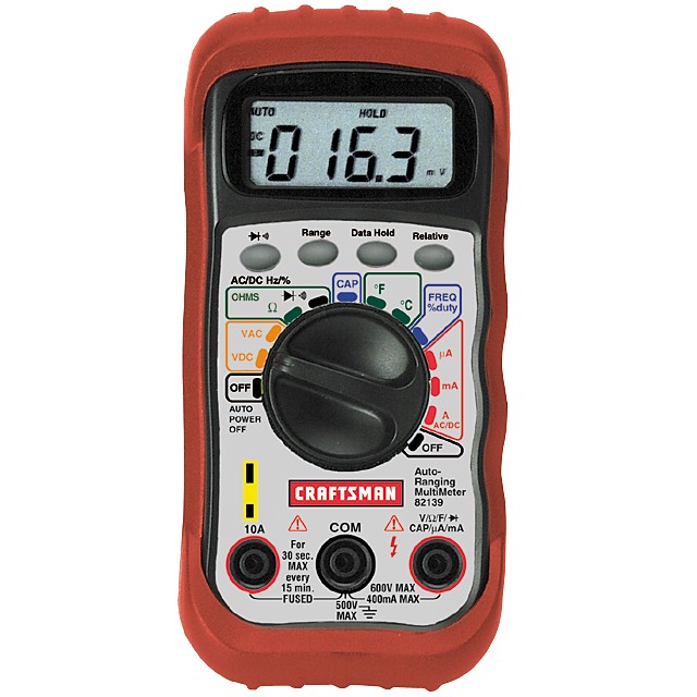

Can you believe Sears has this multimeter for just $30.00?

Set the meter to 10AMPS and be sure to move the leads accordingly. Put the positive lead of the meter to the + battery terminal(or cluster terminal) and the negative meter lead to one of the cables you removed. Be sure that everything is off. You should never read any more than about .020 AMPS or 20mA. Continue checking each of the leads removed from the terminal in this manner. If you do find one that is pulling more, trace where it is going.
Incidentally, my coworker just figured out his alternator was a very large current draw when the engine was off even though it put out current fine while it was running. Internal short to ground.
One last point for people unfamiliar with current meters. The current portion of the meter is protected by a fuse. If you ever try to measure current higher than the meter can, it will blow the fuse. This will render the current portion useless. That is unless you are trying to measure "0" current draw which it will lead you to believe, all is well. Many have been fooled by a bad fuse into thinking they didn't have a draw when they actually did.

I may go by sears and pick that one up!

I pulled the cables(fusible links?) from that junction box, and measured them. Some read .02, but one read 4.58! and even sparked a little with it touched the post on the cluster. Guess I need to find where that goes.

I disconnected the amp wire from the battery and placed the positive lead on the + battery terminal and the negative lead on the the amp wire. showed 4.43, and the amp shows it is turned off.
just for fun I placed the + and - lead on the respected terminals on the amp while it was turned off(still connected as if it was in use) and showed 4.72.
disconnected the ground cable from the amp and did the same and slowly dropped(almost 2 minutes)to 3.72
probably going about this ALL wrong, I guess I just like poking this thing at stuff

faulty multimeter...exchanged it, and now reading fine. Disconnected the amp after driving(in case) batter read 12.1 volts. We'll see what happens later.
