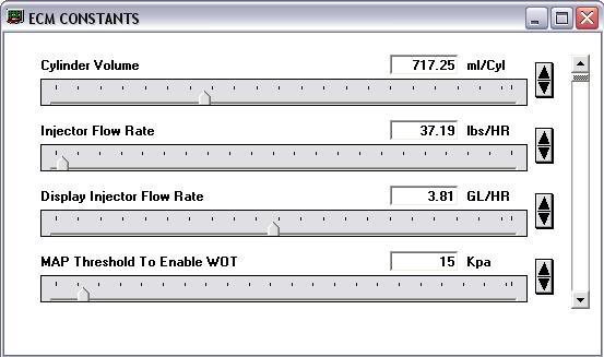

Replacing my 30# injectors running at 90% DC with 37# injectors this weekend.
I know there is a parameter in the tune that must be changed to account for this. I have the ability to tweak my tune until I can get it to the dyno and get a good dyno tune..
What is this parameter and what should i set it to to get me by in the short run?

Just the injector flow rate needs changed, nothing else.

You need to change the "injector flow rate". If the new injectors are rated for the same fuel pressure as stock, set the flow rate to 37.

What is "display injector flow rate"?
It's for the "DIC" fuel mileage readings in the Y-bodies.
Therefore it does not get touched.
Correct?
Old Oct 8, 2008 | 02:55 PM
WS6T3RROR's Avatar
Joined: Oct 2001
Posts: 1,517
From: Engineerland
Thats right.
