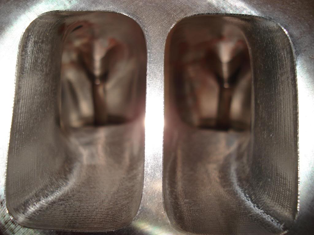

Re: trick flow genx 195 heads vs ported stock heads??
AI 200cc heads. You might wait a bit and have to ship your heads, but what you get back is the best performing ported stock heads you can buy. I run these heads on my run-of-the-mill 383 and put down the numbers in my sig.
