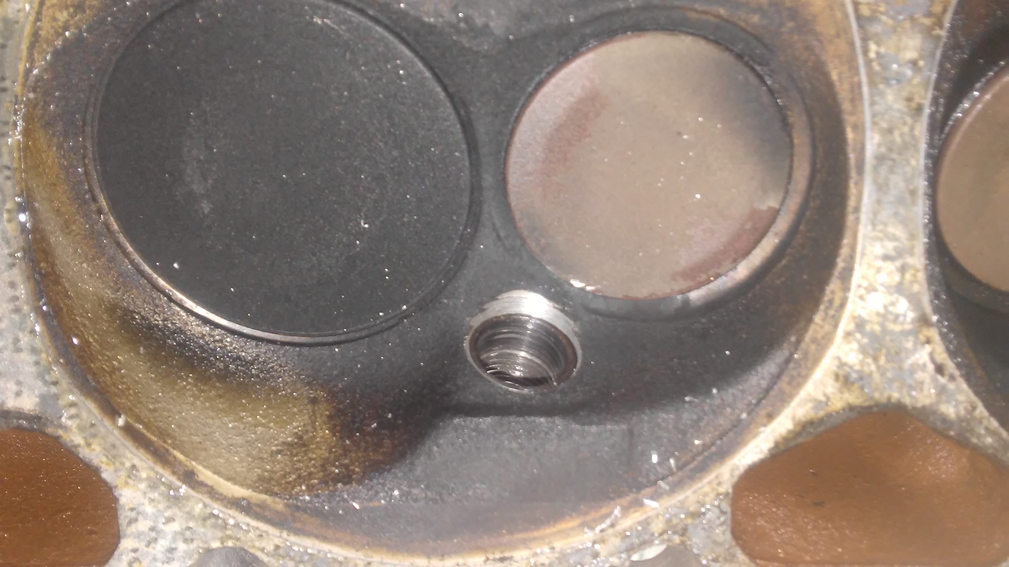

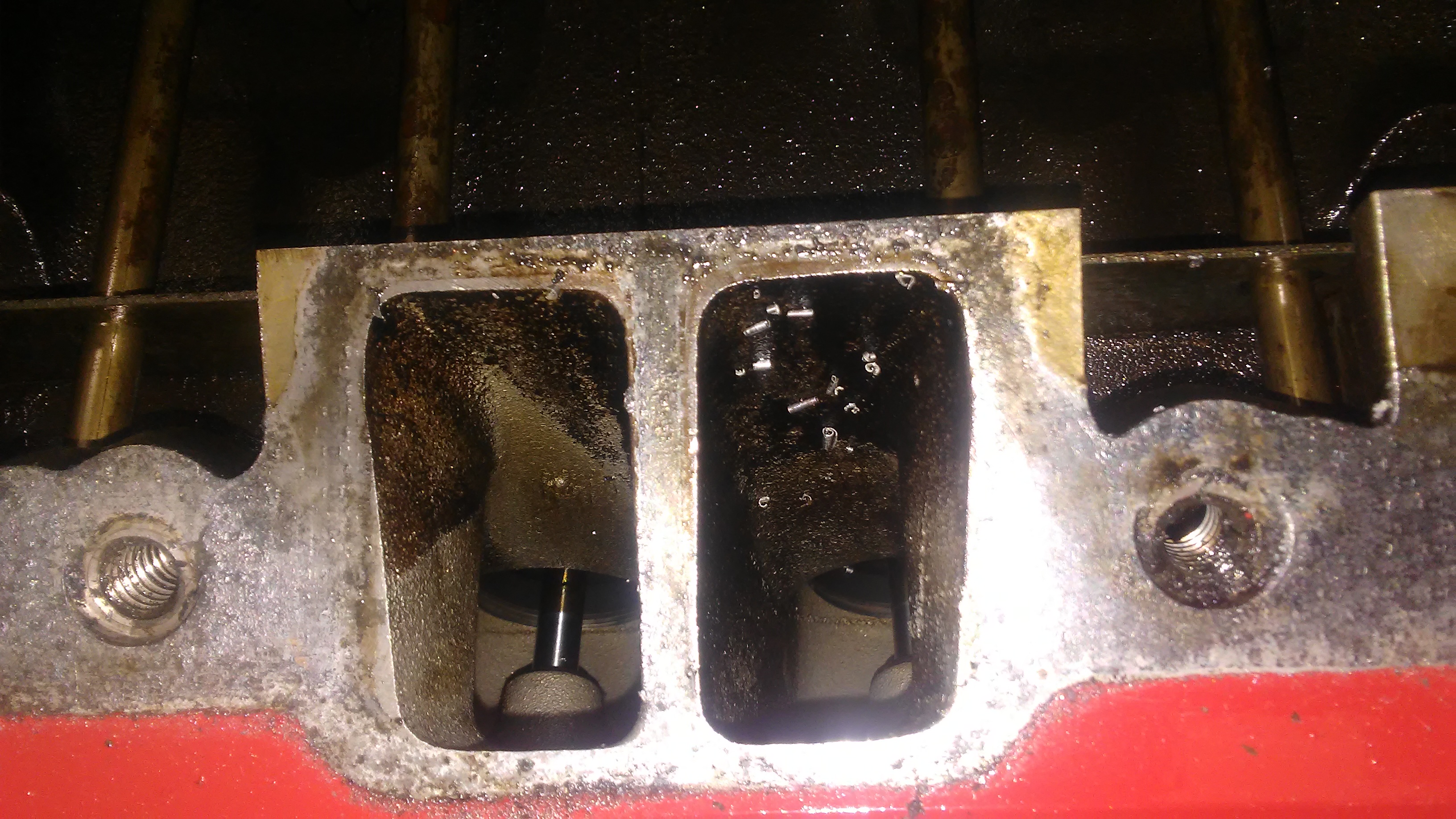

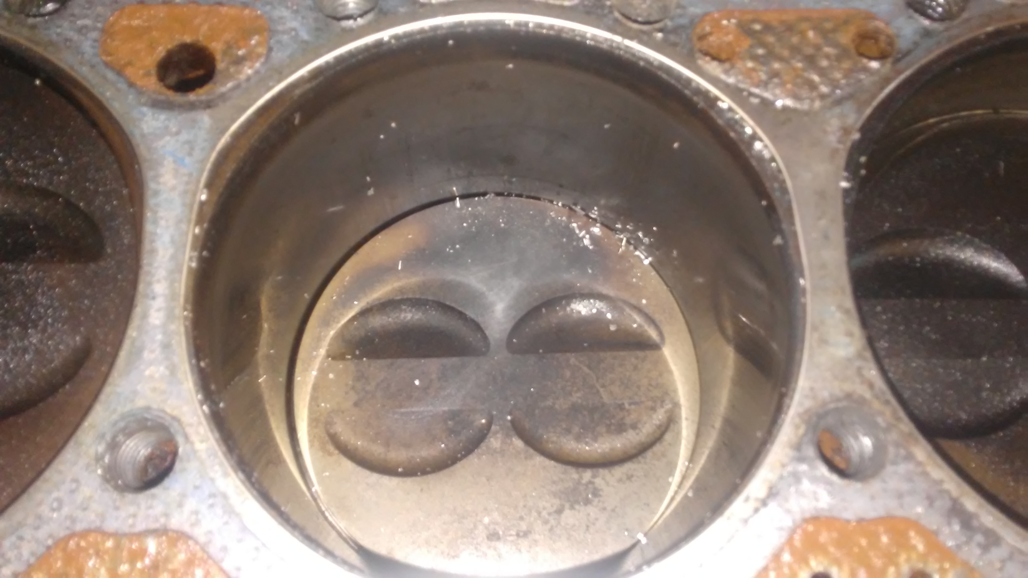

Spot-on my friend! I was in a bit of denial about it when I posted after the compression test. I ended up pulling the heads and found the cause of the problem (I think). It looks like after the engine was pulled from the donor car by the guy I bought the engine from, he stripped the spark plug threads for #5. They drilled out the hole and put a thread insert into the head, but during the process they nicked that exhaust valve with the drill, and also left all the metal shavings in that cylinder. Some of those metal shavings got sucked through the exhaust valve during my compression testing and managed to bugger-up the exhaust valve seat just enough to keep it from sealing completely
The shavings that didn't get shot-out of the exhaust valve had a joyride up and down the cylinder wall and left some decent scratches.
Looks like I'm just going to do the full rebuild now. I got a pretty decent quote from a local engine builder to fully machine the block and heads and assemble the long block with me supplying the LT4 cam kit. Thanks all for the input!!
The shavings that didn't get shot-out of the exhaust valve had a joyride up and down the cylinder wall and left some decent scratches. Looks like I'm just going to do the full rebuild now. I got a pretty decent quote from a local engine builder to fully machine the block and heads and assemble the long block with me supplying the LT4 cam kit. Thanks all for the input!!
