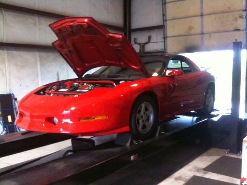

Old Oct 29, 2011 | 03:20 PM
  #27
spilner's Avatar
Joined: May 2010
Posts: 189
From: Lake Norman NC
Re: Street build lt1
442 hp and 450 torque I got videos. Will post soon
