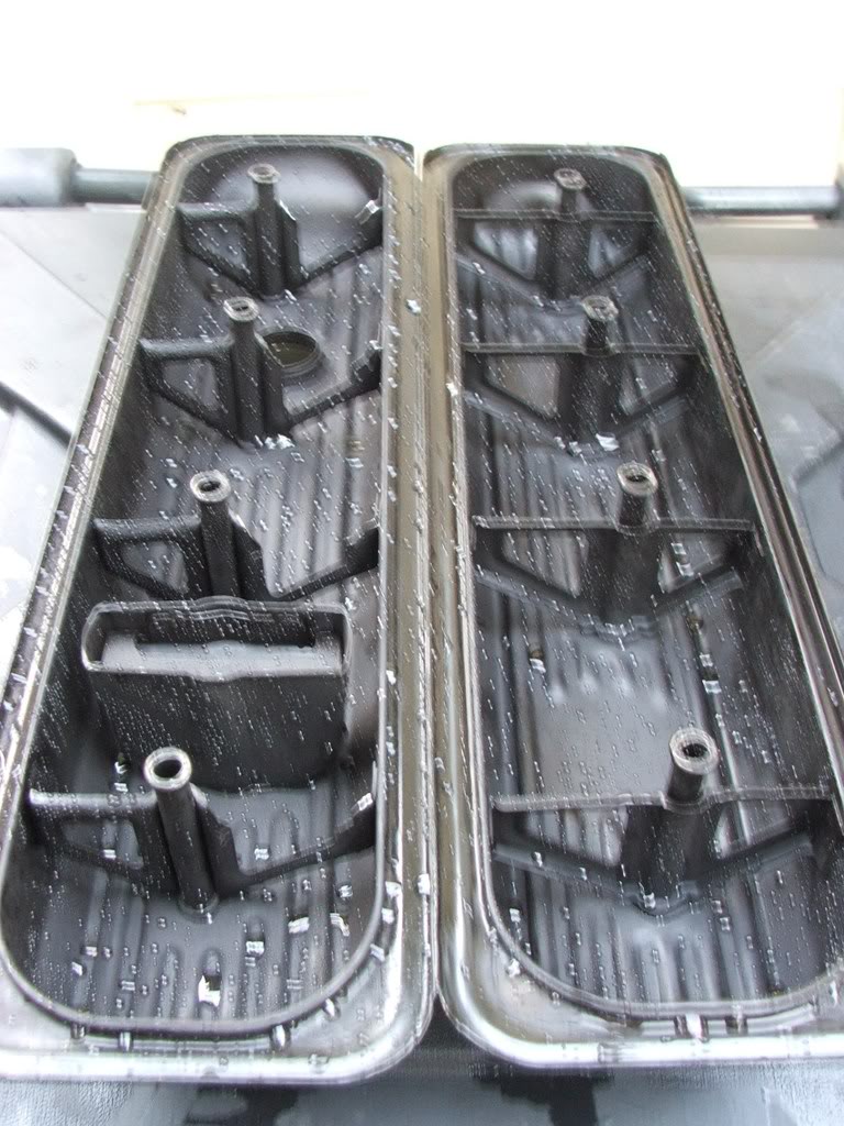

this is all you have to do
Thanks! I needed to know that
