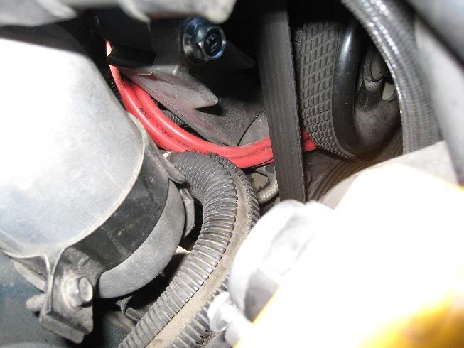

I just changed my wires to Taylor 8.0mm and NGK plugs she runs like a dream now 197k miles. Even dusted a new GT. I dont like how they dont go back in the looms due to the size... they look to close to my power steering pump!!! What can I do to fix this BS its already hard enough getting them behind that pipe on bank 2 above the AC what can I buy or make to fix this clearance issue with stock manifolds.

i just ran my plugs the original route on the stock acc. bracket without the wire loom. my wires were just a little close to the pump too for my liking. So the little hole the loom pops out from, i ran a zip-tie over all of the wires that pulled them back closer to the acc. bracket, and away from the pump. Hope that makes sense. And if your **** with them touching each other, u can run a zip-tie between each wire for spacing. Just and idea. Good Luck.

Zip tie. Just arrange the wires so that they are far away from the belt tensioner and PS pulleys.
