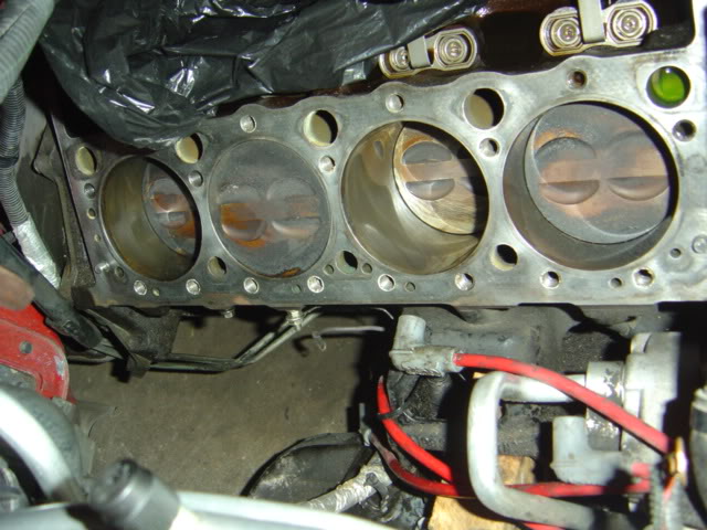

Mr. Gasket says it doesn't matter, AFTER they told me I couldn't use them. So I don't think they know what the hell they're talking about. At least not the guy I talked to! Summit says it doesn't matter, as long as all the holes line up. Now, if both sides were kinda similar, I would believe what they said, BUT......
The two sides are very different, so that leads me to believe there has to be a certain way for them to be installed.
As you can see in the first pic, that side has more dimples than the other side. The other side has like little compartments that look like they seal off certain holes from each other.

It would be my inclination to install the top picture as face up.

Shoebox, that was my original plan. It's just a WHOLE lot easier to make sure and do it right the first time than replace them while in the car after I figured out I messed up!

Just to be clear, it is actually the 2nd pic should be face up correct?
That is the side with the part# on it and look closely at the smaller holes on the bottom part of both pics, the smaller holes that have the bigger holes on each side of them for the bolts.
Notice in the second pic the raised portion for sealing.

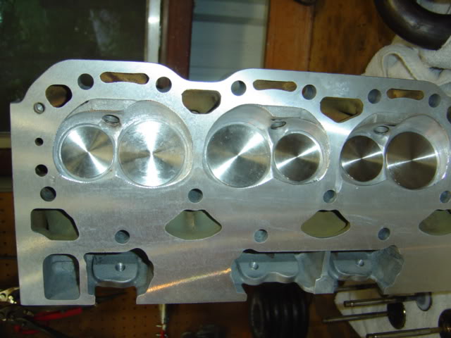

And then this pic of the bottom side of the head, notice its not just a small hole, its an oblong shape (at the top of the head in this pic) , that will fit right inside that part that has the raised seal on the gasket.

So its actually the 2nd pic, not the first as earlier posts guessed, that should be facing up... or it could be that the raised part of the gasket is enough to place pressure on both sides of the gasket when its sandwiched between the block and head that it doesn't matter...
